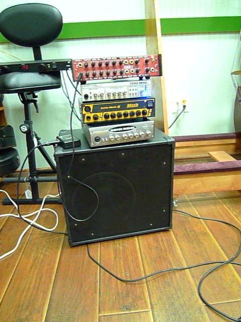

This pic is when we had an amp shootout at work. Mine is the Markbass.

Looks like a Walter Woods on top. My bass player has two of 'em.

It is a Walter Woods indeed. It's a great sounding amp with an awesome EQ. I was able to get the Markbass to sound pretty similar though.
Re: Simplexx 110
That photo says a lot about what the comparative size of the cab is. Thanks!
