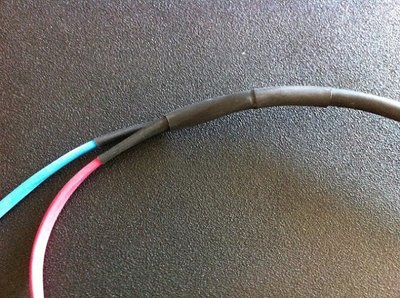

As far as the cabling - nothing says you have to use only one connector on the end of a 4 wire cable. make two pigtails with a speakon on each one and now you have two speaker cables in one.
I built these for my subs. Just takes a little heat shrink and you can make 'em look like they came from the big store in the city.
