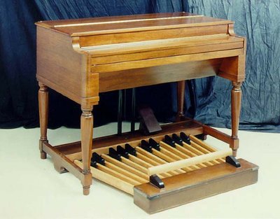

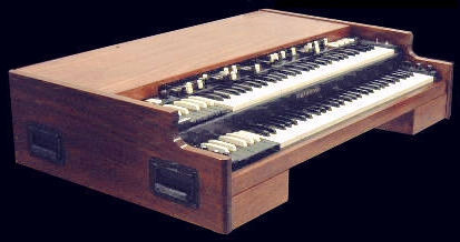

You could do a Hammond cabinet clone, stretched for your 88 keys.... Lowes has the legs. Omit the pedals, of course. Or do a chopped Hammond-style. Mostly simple carpentry. Stair treads would be fairly inexpensive and have good grain.
