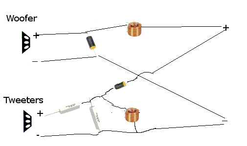

Re: How do i wire my crossovers for a J112 with piezo array
This shows a physical layout. Except you might reverse the polarity on the array.

+ 1 for the awesome diagram. Makes much more sense to me this way
