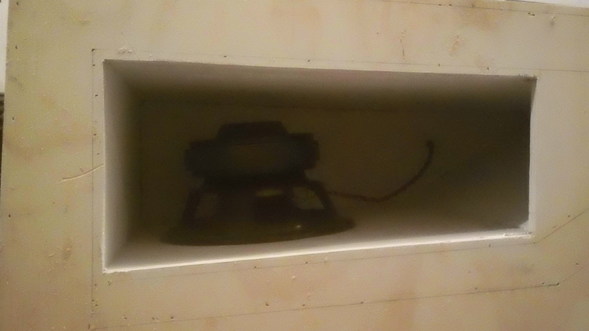

well here's 6 hours of work! I'm amazed at how fast I worked! it's funny these things are the same panel layout as the t60s!
imo this is the cleanest looking cab i've built. I could have finished, but forgot my sander at home and I want to sand the mouth before I put the last panel on. also it is 105'F and high humidity so 90% done i'm happy with. I plan on carpeting it, and the chamber will be white along with the mouth. I may led up the mouth but likely not because it is going in sideways so you won't see it. can't wait to trial run it! is it true that you can hear the driver being overdriven with the autotubas?

I forgot to say I made the access cover larger to see the driver better.

It is all done!!! woohoo! well not quite, I need to put carpet, binding posts, leds, and plexiglass :( . but the plexiglass is cut and drilled! I used 1/4'' acrylic stuff and it was 20$ for a 12x18 piece at fleet farm. I was worried about it spiderwebbing, but it didn't. I used a circular saw and had the blade as deep as it would go to prevent chipping. there never was a hint of cracking or chipping, maybe I was just paranoid.
with my access panel mod (widened it to panel 2/4 joint) I was able to install the driver effortlessly without a second access panel. that was with tnuts and hex screws. I don't know why bill has it so short :?
