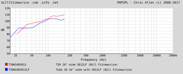

Use 4 and power shade them, with less power to the lower cabs. Just wire the bottom pair, in mono, to one side of the amp, and the top pair to the other side of the amp, easy as pie. Low passed at 100Hz, and you are rockin'.SirNickity wrote:Really? DR200s up front? I'm planning a pair or two of those anyway for live / high-volume use. So, while having adequate volume at the farthest end, that wouldn't overpower the poor folks ~10ft away?
BTW, have you thought about using T39s instead of T30s? At 35Hz, the T39 just walks away from the T30, in terms of total output.
Unless you are playing bass-heavy electronic music, T39s are the better choice. A bonus is they will work well with live acts, as well as recorded music!

Absolutely, I have thought about it. Both Tubas and Titans are already sensitive, and they both go quite low. But, if I have to compromise, I'll trade extension for volume. Not every song I play will have 30Hz content, but some will, and they'll be loud and proud!BTW, have you thought about using T39s instead of T30s? At 35Hz, the T39 just walks away from the T30, in terms of total output.
