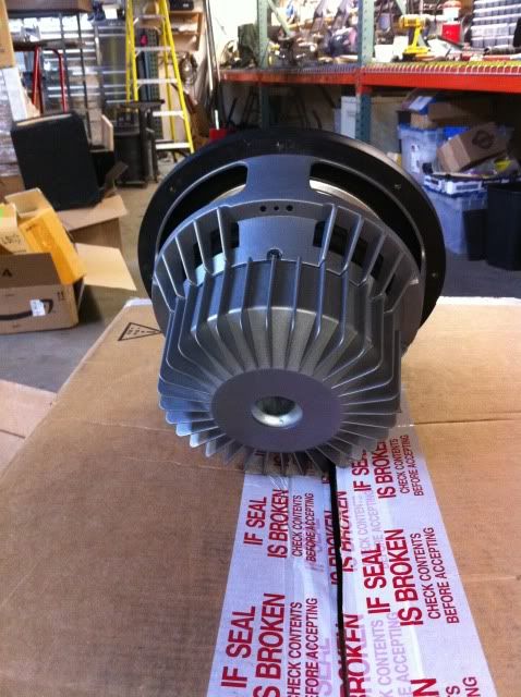

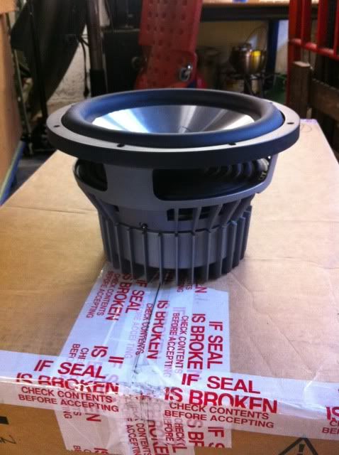

Stumbled across this page on looking to get better bass outside. I'm thinking about building a tuba 30. I have a Eclipse sub that I would like to use. Where would be the best place to ask if it would work? I still have the manual, and all the specs for it..

I was thinking a tuba-30 (or two) would suit my needs as I have a Eclipse SW8200 raw 4ohm sub that I'm hoping would fit the bill. Also I would be running whatever I build off of a older MTX Thunder2300 amp, which was a beast of an amp back in the day.
I have been doing some searching though and it looks like the tuba-30 needs a sub with a somewhat high Fs, and the Eclipse has a Fs of 16Hz

The Eclipse driver is a 3 Ohm piece. Qts is fine, but as you say Fs is lower than you want. The MTX amp is a car audio amp. Sell both and use the $$$ to buy a driver that meets the specs, then use a cheap crossover to run both your tops off one channel of the A500 and the subs off the other.sprsho wrote:Sorry to be so vague.. My current set up is a Dell laptop running windows 7, with itunes, and mixvibes program for mixing. Also right now I have 2 Cerwin Vega VS-120 speakers for my front stage. They are running off of a Behringer A500 amp.

That's too low for any of our cabs other than the THT, and that's a poor choice for music.sprsho wrote:

I don't know about the driver, it may work but we don't know how well. As you can see, Bill as answered. It's recommended to pick the drivers as per the plans rather than use what's on hand.

I don't think that sub would fit in the driver chamber in any of Bill's designs. It looks faaaar too deep. Maybe it's just the picture though.sprsho wrote:Thanks for all the info, and quick replys!!
