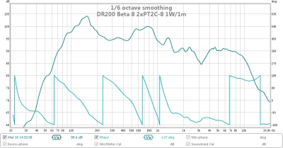

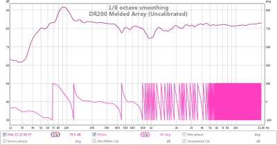

Here's the chart... they're not as sensitive as the piezos, but because you're biamping, you can compensate by simply turning up the amp a bit. This can change the phase relationship at the crossover point, so you have to be careful not to lose response there, but my experience has been that it's not a problem. These have such a nice linear phase relationship it's amazing. Also attached is a chart of the same cabinet before the refit while it still had a melded array (SPL is not calibrated on this chart) - notice how the phase relationship of the piezo array is much more ragged. This may or may not be of any consequence, but the ribbons are much better at rejecting feedback, and they sound better with a single cab in play than the piezos do, even with both systems calibrated and EQd.
dr200 ma uncalibrated.jpg (28.46 KiB) Viewed 7409 times
DR200 1W/1m Beta 8 2x PT2C-8

The piezo frequency response looks amazingly flat and extends up to 20k easily - but the phase response is terrible. The ribbon is flat only 3k-10k , but with close to perfect phase response.
Peak SPL for 2 ribbons is about 117 dB. Any idea what the peak SPL for the melded piezo array is ??
