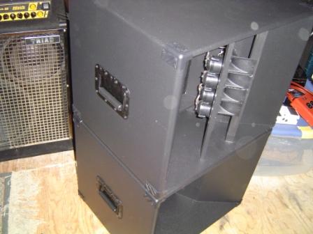

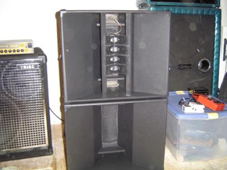

Here is my new bass stack. I finished the full-range Jack 12cab first, with 8 piezos as recommended in the plans for bass. I then wanted MORE of everything, and commenced on #2. Bill recommends increasing the piezos to full strength when combining 2 cabs, and I may get to that some day. Anyway, I will be hitting the road with these Friday night, I posted a gig on the "come hear them" forum.
At first I was underwhelmed by the combination, I expected much more punch and low response from the additional cab. But
I've been tweaking the eq and getting closer to what I think will work. One strategy I want to try is to spread the cabs out on stage, putting one on the other end away from me. This will hopefully give me a better feel for the projection of the sound, rather than standing in front of the stack, aimed at my knees.

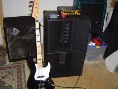

Rig= Fender Geddy Lee j bass; LM3;Tech 21 VT (aka the secret weapon); Jack 12 and another Jack 12.

With a G.Lee bass and a Tech 21 I guess you're modeling after Geddy's sound, a bit? I'd be curious to find out how the 8 piezo works out with that setup/sound. I too was confounded with how to EQ my J110 versus direct radiators but settled on something close to flat all the way. And ditto, speakers will loosen up after some use and increase bass end.

That's usually a bad idea, the rules of sub placement also apply to bass cabs. Just tilt the upper cab up; one of Leland's tilt rigs is perfect. Add a couple of rubber feet to the rear of the top of the cab, to keep your amp from sliding off.cboogie1 wrote: One strategy I want to try is to spread the cabs out on stage, putting one on the other end away from me.

That's mainly a problem with guitar amps, as commercial offerings have the worst possible dispersion. I can hear my J112 fine when tilted back, with a pair and the top cab tilted you should have no difficulty at all. Placing it away from you on stage would probably have the opposite of the desired effect.cboogie1 wrote:Thanks Bill, that's good to know. What I need to be careful of, and we spend a fair amount of time as a band talking about, is playing at the right volume. A big part of that, we've come to realize, is not placing our amps on the floor, aimed at our knees, and then turning them up until we can hear ourselves.
