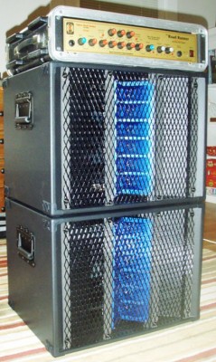

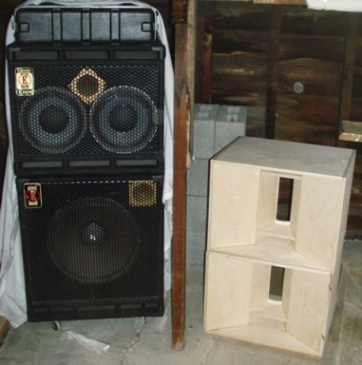

Hey Everybody, I'm excited to find this community, and Bill's designs. I've started my first build, a pair of Jack 10s with Deltalite 2510s and full melded tweeter arrays for bass guitar. Why full arrays for bass? I don't know!! Maybe I'll use them for PA later, or maybe I just like the idea of the truest possible sound reproduction.
My old rig was an Eden Roadrunner, Eden 2x10 and 1x15 XLT cabs. I've been longing for less weight and more accuracy. I think I'm about to get it!
I'll let you know how it goes. Should finish in a week. Anyone using these cabs in the Bay Area? I'd love to hear from you!
Alex

Finished! :hyper:
I'll post again in Reviews after I've had a chance to gig with them. Overall, I'm really happy with the look and sound. Fun project!
I was all excited to take them on tour to LA and San Diego this weekend with my band Luce, but I just found out backline is provided (and required) on all three gigs. Usually I'd be thrilled about that, because I don't have to load in, but now I'm bummed that I can't test my new toys!

You'll want a switch to turn off the tweeters is the lower cab, otherwise the vertical dispersion of the highs will be so narrow that you'll have a hard time hearing the highs on stage.

Bill, I have a DPDT on/half/off on both cabs. Are you saying leave them off all the time on the lower cabinet?

They'll probably sound better that way. Vertical dispersion with both HF arrays active would run around 5 degrees. You may find only half an array in the top cab will give the best result.
