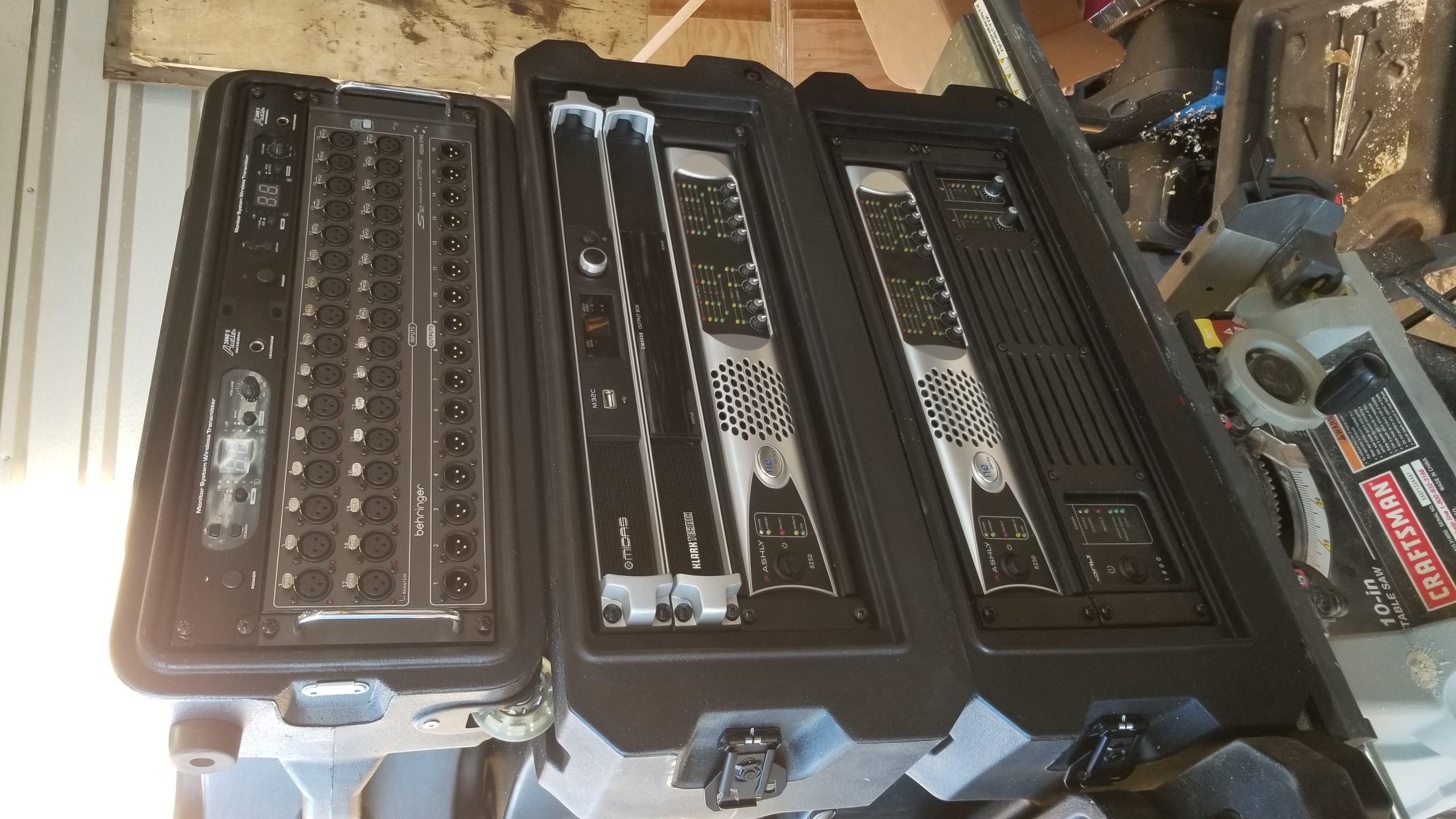

Power con's maybe? Thinking a little about creating a power distribution solution for my system and future gig needs with considerations for power needs on stage as well as system power.
I keep all my gear in 4RU racks with suitcase style rollers to keep it all manageable to handle (size/weight) . As I put together organized rear connection panels the thought of using Neutrik powerCON or powerCON TRUE1 connectors for an easy one and done solution that wont pull out. Are any of you guys using these or have any experience with them? What's your thoughts?
The TRUE1 solution looks pretty slick (the black and yellow ones in the middle). I like the integrated in/out in one receptacle, would make it easy to run power from one rack to the next, to the next, to the next... as well as there being a male and female plug for easy daisy chaining cables, unlike the standard powerCON that requires an adapter.
Would be great to just have a clean little jumper from one rack to the next that is impervious to accidental pullouts.

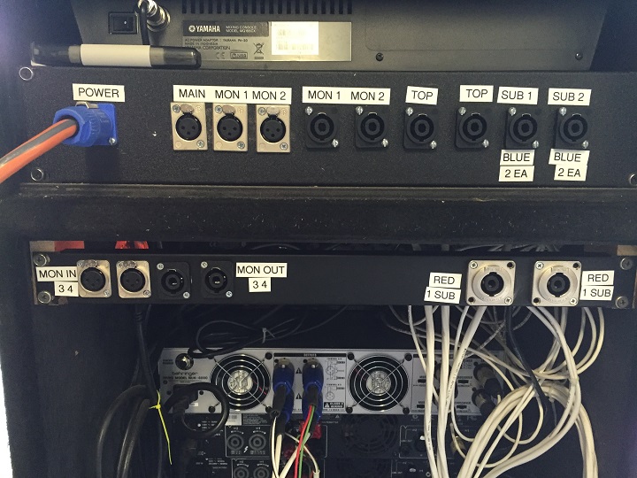

I have put powercons in a few racks that I've built. I do it to keep AC cords from having to be shoved back into the rack and screwing stuff up.
I'd use the regular powercons from rack to rack.
What I do is buy a good 25 ft. extension cord. Cut off the female end about 3 inches back. Solder the female end to the powercon in the rack and attach the interior power strip to that. That way, if you ever lose the male to powercon ext cord, you can always use a regular extension cord in a pinch.
Thought I had a picture of the inside of the panel, but couldn't find one.
