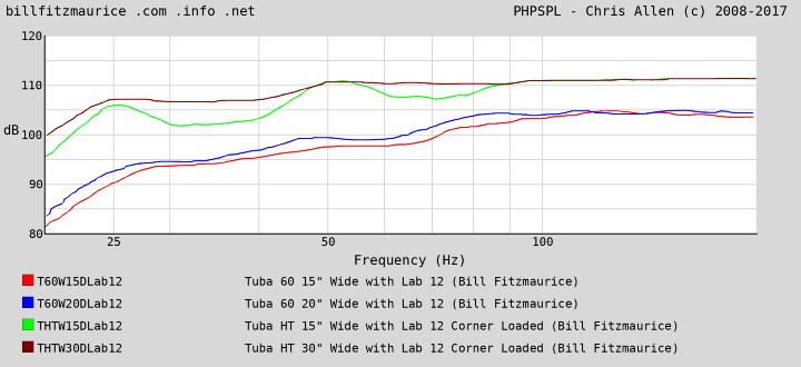

Here are the T60 charts:
Note: corner loaded variation!
I'll get the corner loaded variation sampled when I can.
