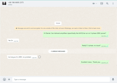

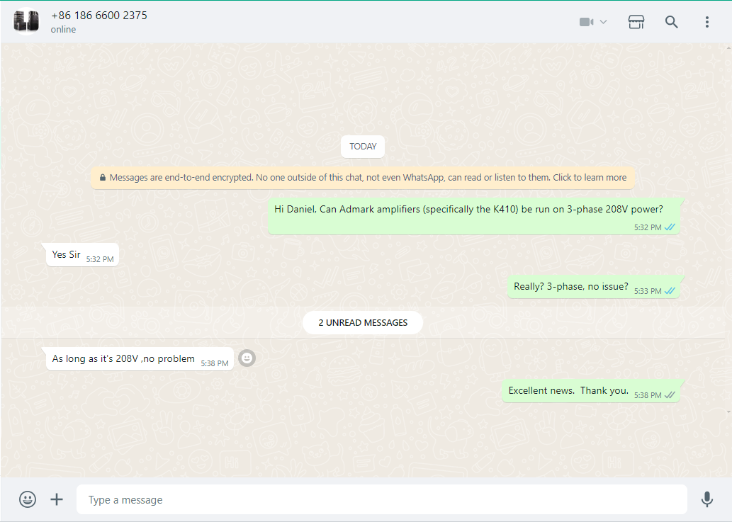

Anything with at least 500WPC at 8Ω from any of the well known manufacturers Crown, Crest, QSC, Ashly, Lab Gruppen, Powersoft, etc.
My hat's still in the ring for the Admark 410, but I have no issue with whatever direction you choose. I like that you're aiming at high end amps. If you're getting 2 channel amps, I'd highly recommend you get 8 of them. That link I posted for the Admark 410, I took a look at it the other day and they've sold out of every other model and just have the 410's in stock.

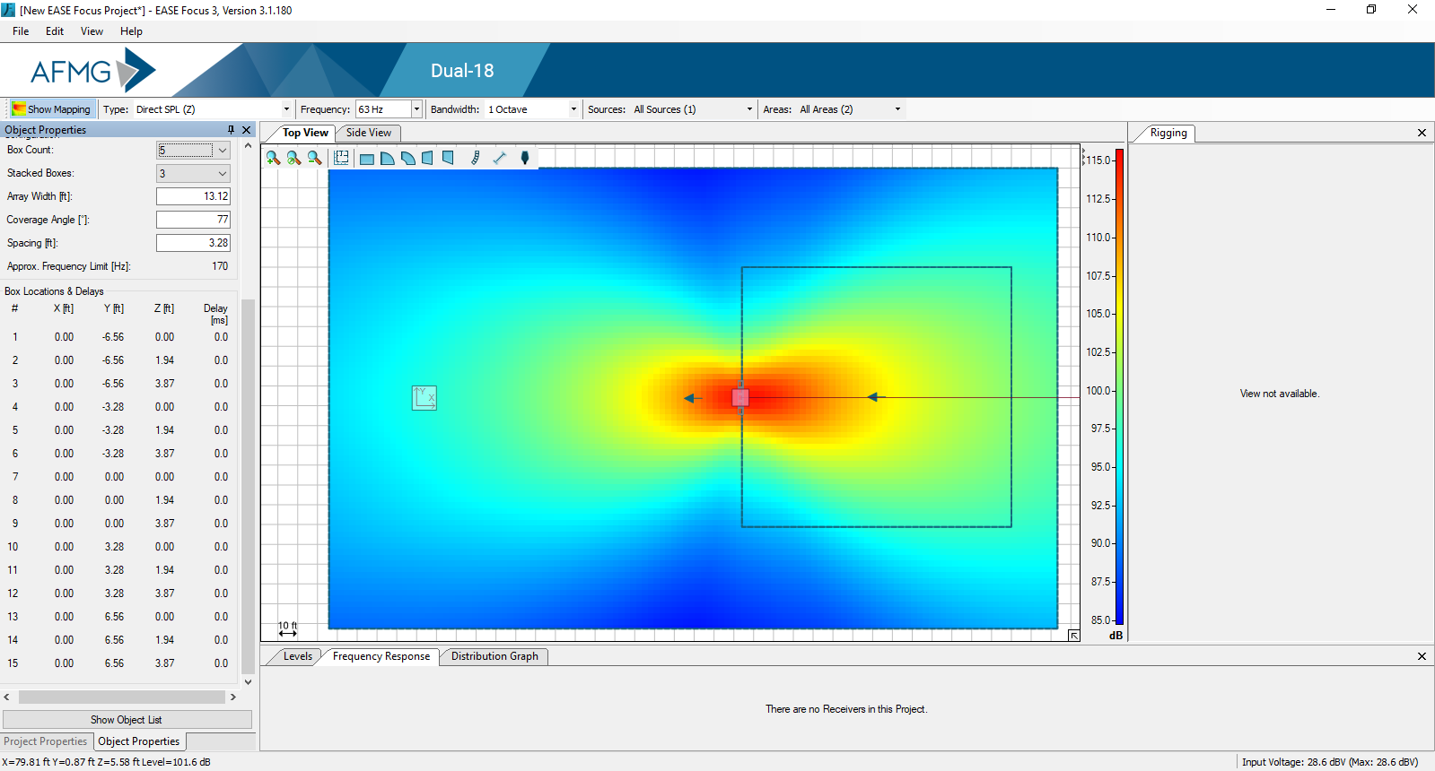

It sounds like you're leaning toward lining them all up for a 20" high, 5x80 foot long dance platform. If the vision of that and creating the space and ambience is paramount to the best configuration for sound, I won't criticize. I get it. I would definitely have them on their sides if you want people to dance on them, instead of 32" high. The sides will have more internal support compared to the top or bottom of the cab.
What I'd love for you to try is the above configuration with and without some delays, then flip every other cab end for end and delay for cardioid cancellation to the rear, then that configuration with added delays for steering the sound/beamforming.
Then go double deep, creating a 10 foot deep by 40 foot wide platform. Front row of subs mouth forward, rear row mouth back, delayed for cardioid cancellation to the rear.
Then 8 stacks of 4 cabs on their sides, creating a 6.6 x 20 foot wide straight wall, with and without delays. Then curve that wall, with and without delays.
And then, two stacks spread as wide as you could go.
Then choose the configuration that best fills the desired space.

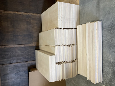

Seems to be a few more drivers in that pile than I expected. Sup wit dat?

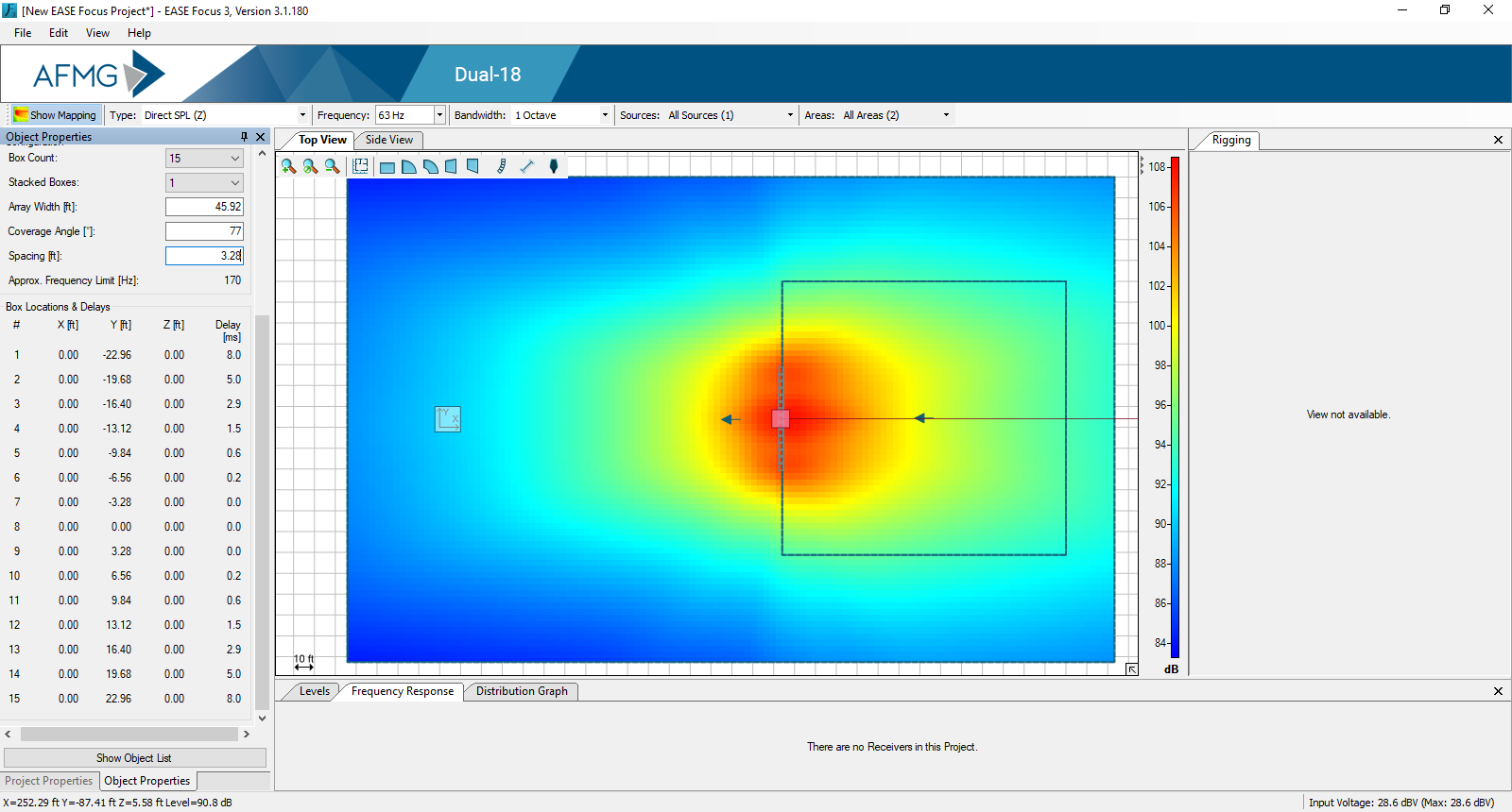

I did a little fiddling with one of the simulators and it looks like the wide option will have wider coverage at the cost of peak output potential. The tall wall stack will have greater output potential with more centralized pattern.
One is 15 cabs (2x18" ported) wide. The other is 3 high, five wide. Note that the SPL scale on the top one (wide array) indicates the red area as max 108dB and the bottom pic (tall array) red area maxes at 115dB. A considerable difference, indicating the wide array would require more than 4x the power to reach any particular volume the tall array may be set at. Yet, the hot spot is smaller.
These numbers are purely for identifying trends and patterns and aren't correlated to the output potential of the T60 in any specific way. The square on the right is 100' by 100'.

Good eye! We have a few extra LAB12 and 3012HO drivers as backups! Just in case maybe something happens. Seems like something always happens. No quick run to the store out there!

The Admark K410 does not have integrated DSP. If needed, you could use the two 4820's on subs and the PA on the DR's.
I suppose the option still exists to route the signals back in/out of the M32 if additional delays were to model significantly better. But, so far I only seem to be able to model 2x18 cabs, essentially the width of two T60's. So, I might not even be able to model any finer than that. We'll see.
That said, though, do you think the 410s could run off of three phase? My guess is probably not. But that would be a way to get to 208v. Which would be way better than 120v, but not as good as 240v of course.
I contacted the rep at the number provided on the Admark website and he indicated they would work on 3 phase.
