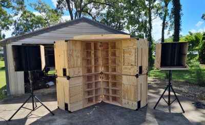

I cued up all the neighbours songs, and let it rip for 3 hours this afternoon... still cant stop smiling! Finished up with Enter the Sandman really loud, the system not even breaking a sweat, the amps were still cold!
These DR280s would outperform my TLAPs, it's just hard to believe how!
My mind has been blown with the effortlessly powerful precise bottom end, and face melting clarity of the DRs

See, now that's what I'm talking about. A simple, elegant, and stylish sledge hammer. I can tell you took that pic before you started playing it... the structure behind is still standing. LOL
I think anyone doing recorded content outdoors should consider a sub stack like that as the standard starter pack stack. You pretty much can't go wrong with that setup, unless you need to be able to transport your system in the back of your Honda Civic. Also happens to be the finisher stack for most too. Not too many of us would need more than that.
So jealous. I bet that was three hours of heaven. You didn't happen to get any video, did you?

In my opinion, inconsequential mistake aside, that is the quintessential combination. It would take 9500 watts worth of amplifier and six double loaded 18" JBL's (12 drivers total) to match the long term low frequency output capability you have right there, with only four 15's and less than 2kW of amp.
Sound quality and peak output potential, I doubt there's a system in all of Australia that can match it, on a single standard (in New Zealand and Australia) 10 amp 230v wall socket/receptacle.
