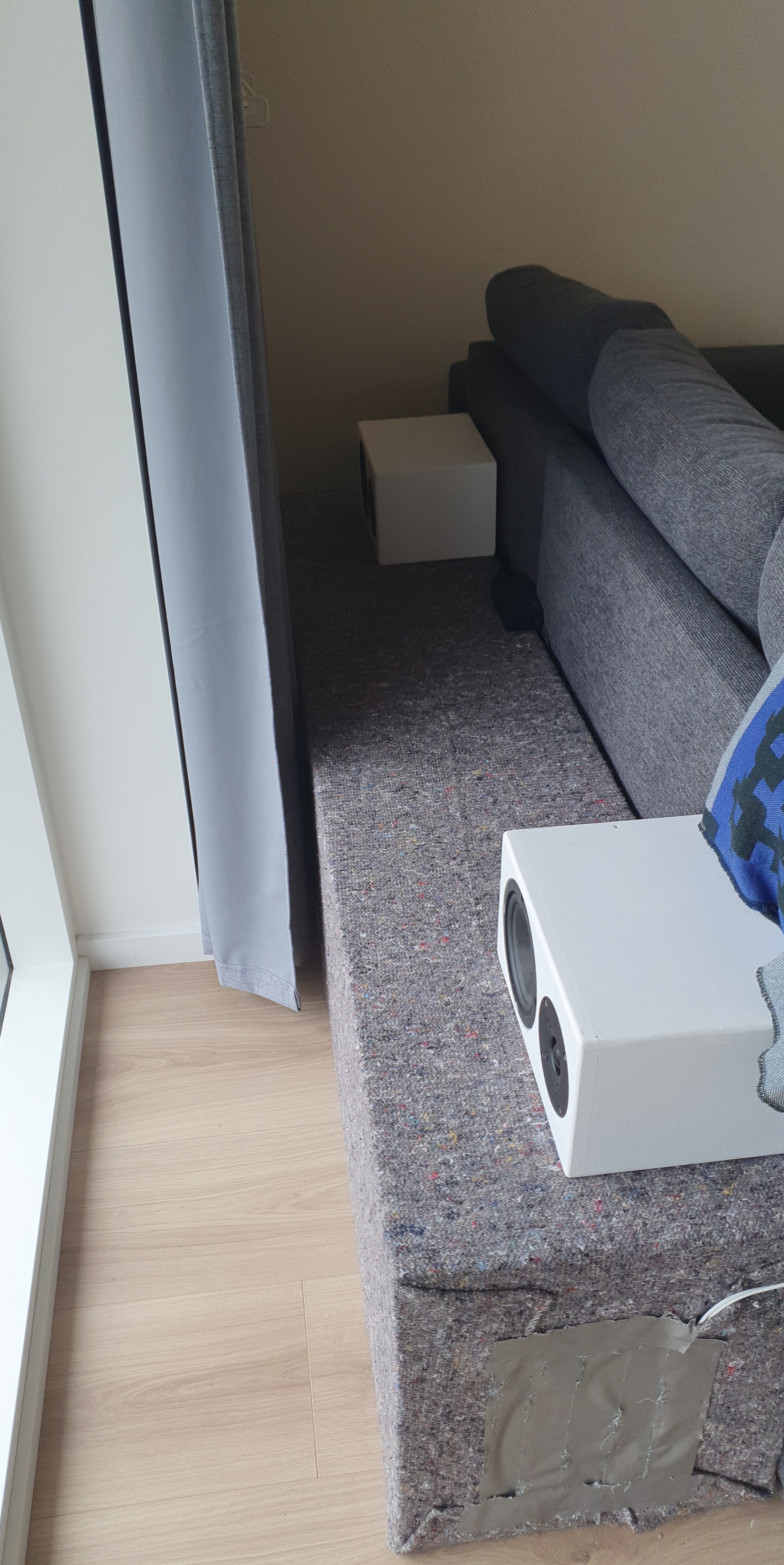

Can't cheat you for final implementation pics. (Only need to finish the cover)
I can't really describe why this sub I so much better than all the others that I've had. It even fills my room better, even though I know the room modes should be the same.
But I don't need to know. I just love this sub.

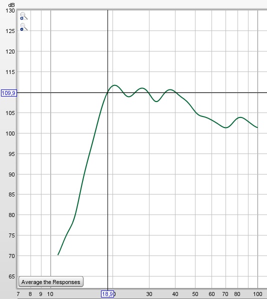

24 volt support
it clips at 16 volts. So it can provide around 50w. The sweep I posted is at 14 volts or so. With an 18 Hz highpass filter, which I have lowered to 14 Hz if I remember correctly. I got a little notch more at 15-18 Hz, but not anything audible. I added the highpass, because I only hear higher harmonics if it attemps to play the lower notes at full tilt. Will never really happen - but it shows through in the intro to Edge of tomorrow (be careful if you try it with dynamic EQ on, it will send your driver flying)
And Seth - this is even a 2.1 amp, so it's three times bigger than necessary. 2/3 is satellite amps.

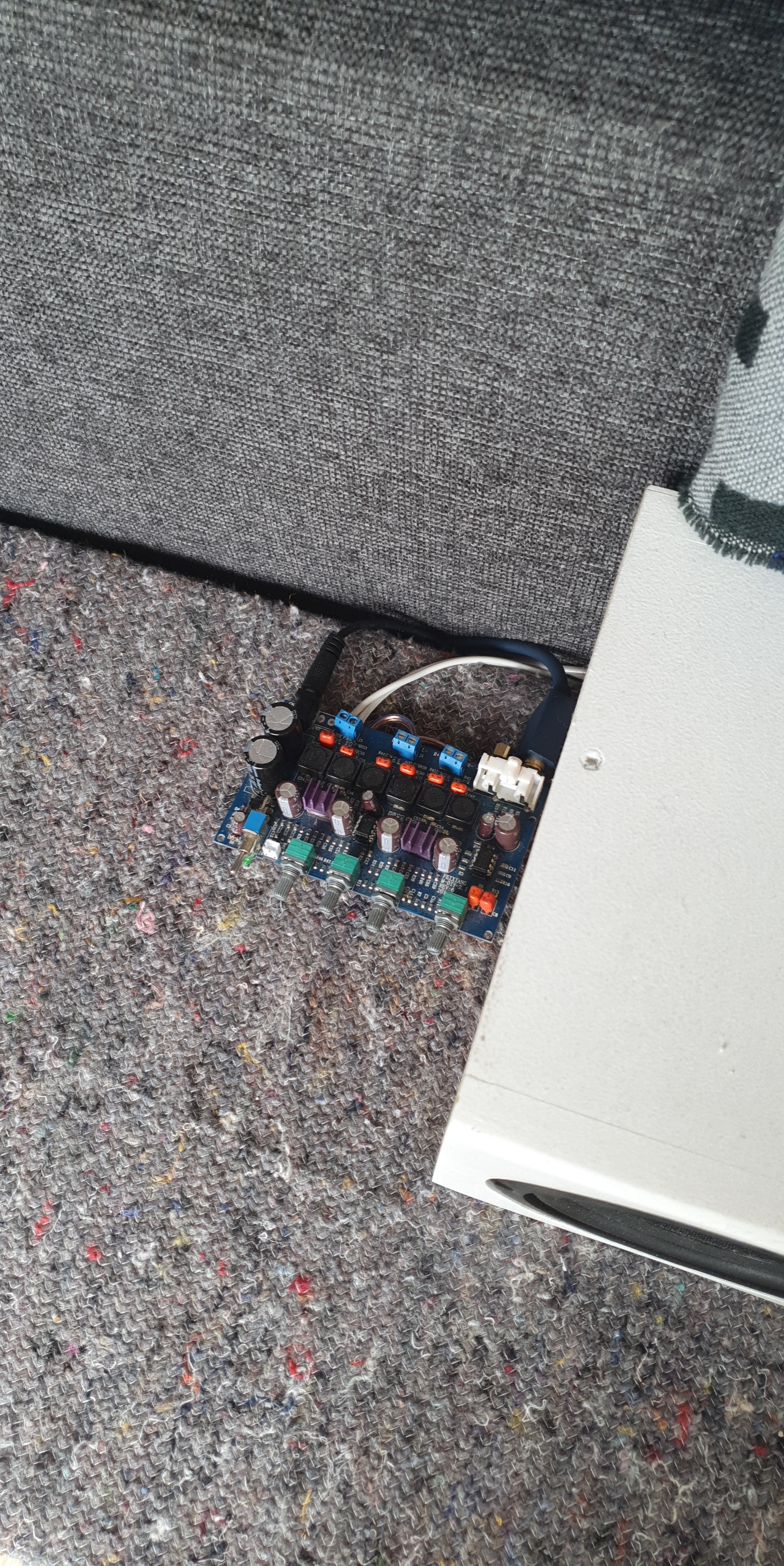

Re: Slim THTLP
What kind of amp is that? It looks so....small...
Joe
Joe
- Posts: 140
- Joined: Sun Feb 28, 2021 6:43 am
Re: Slim THTLP
Similar to these:
https://www.soundimports.eu/en/audio-co ... oard%20amp
You supply them 12-36 volts. It's a chip amplifier
