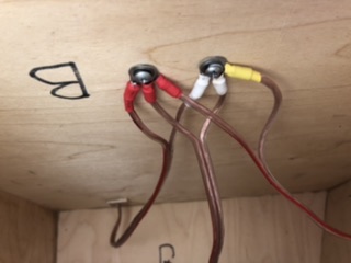

himhimself
- Posts: 643
Re: Things that go boom
stalled out for a bit. had surgery on my left arm tues, wont have use until at least next fri. getting close. have 6 of the 8 speakons wired up and installed. need to do the last two, install drivers and finish terminations in the boxes, then fit, drill, attach access doors. i think that is all i have left to do

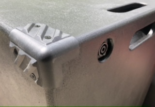

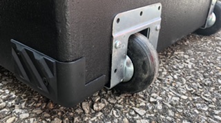

himhimself
- Posts: 643
little bit of progress since getting out of my sling yesterday. Corners and wheels are on. Jacks installed and wiring inside done. Touched up the duratex in a few places. Drilled the access doors and flanges, then countersunk the holes in the doors. For the screws in the corners and for the doors, this time i just took #6x1" fine thread drywall screws, stuck them in a piece of foam and hit them with a rattle can of semi-gloss black. Cheap and they look good.
Waiting on gasket tape from Amazon, so can't really do much more at this point. Arm is useless in trying to pull my amp rack out of the trailer anyway, so no rush. Will post some pics momentarily...

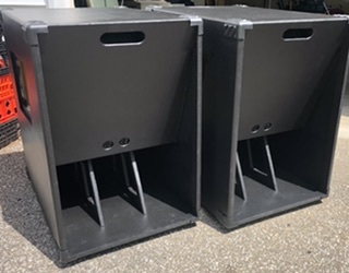

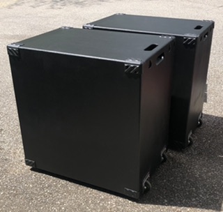

Some evidence
- Attachments
- 53C7EBD8-7071-411E-9ED4-38A3A6CBB88B.jpeg (30.15 KiB) Viewed 1739 times
- F720AC23-395F-4567-AF3E-853C6D859051.jpeg (19.65 KiB) Viewed 1739 times
- 86B3C569-334F-4423-A522-61633D4B4DB1.jpeg (26.6 KiB) Viewed 1739 times
- E9BD5EEE-CDD3-4F8B-8480-220E2F47C22E.jpeg (19.53 KiB) Viewed 1739 times
- 2ECE5090-8900-4901-8A35-0D32072875D0.jpeg (28.99 KiB) Viewed 1739 times

himhimself
- Posts: 643
Drivers in and torqued down snug, access doors on, and fired up for the first time.
All 8 speakons are functional. Yay.
But, some leaks!!! Damn, first time that's ever happened. First one was easy to fix, as it was around one of the speakons on the front panel. Wrapped a little strip of 1/16" foam around the barrel and screwed it back down. Gone.
The other one is a little more insidious. Seems to be leaking out from around corner panel 9 somewhere and coming out the handhold in front panel 7. I think I should be able to seal it up with PL. It's not much, doesn't seem to be a difference in output between the two cabs. Just down around 40-60hz you can hear something going on, first I thought it was a rattle of something loose. With a piece of tube to the ear, you can detect the air escaping.
Close...
