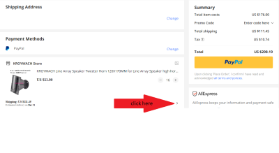

Be careful regarding the shipping option selected should you option to buy from aliexpress.com as their price per unit ratio is highly flawed, there was a resonance to the price drop relative to number of units in cart and sometimes the shipping cost per unit ratio spikes depending on number of units shipped. May have to do with package sizing requirements but look closely at it. I purchased all 16 units in one order and using the cheapest shipping option they offered it came out cheaper per unit than any of the other methods I modeled up.
For fun I just put 16 horns in the shopping cart, and shipping is quoted at $242!!! Is this close to what you paid?

there is an option to choose shipping method. See attached picture, the arrow shows where to select. I switched to the cheapest option and the shipping price comes to $112. This makes the total cost per unit $18.64 if 16 units is purchased.

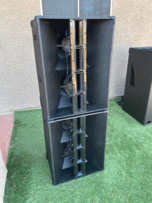

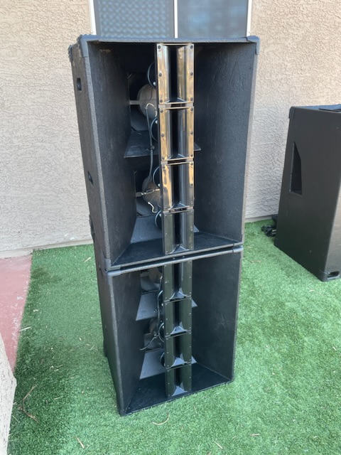

I have completed my high frequency upgrade. From a total of 8 Asd-1001 compression drivers to 16 f151m compression drivers for 8 otop12s. So far these plastic Chinese horns seem to be of sufficient quality. I am excited about this I can’t wait for an event where I can set everything up and let it rip!

Man this is great. Kind of breathed some fresh air into this design and got my interest going again.
Updates on how things have been going?
How has the overall performance been with the Chinese CD Horns?
Has anyone else purchased the horns since November?
Happy New Year all.
Out of curiosity would you be able to fab some dual comp horns from the aluminum if compensated? That being said it sounds like the plastic horns are working out well.
How has the 1” gap been between drivers with them stacked?
Also what lifts are those for the fly and how are you connecting the cabs for the fly?
