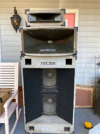

Believe it or not, these speakers measured nearly ruler flat from 500 to 3500 hz in my room on the PA2
But ruler flat is not always the best sound, in a Home.
I prefer a slightly downward sloping curve vs ruler flat

Yes, old school for sure! The midrange drivers are Electro Voice EV 1824M's! All drivers are in phase with 6db simple crossovers, just single capacitor and inductor, real simple.
