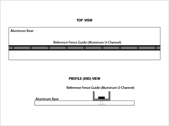

Thanks miked! The circular saw cutting guide jig is pretty easy to make if you've got access to aluminum material. The base is made of 1/4" thick aluminum stock and the reference fence is aluminum U-Channel that is 1-1/2" wide by 3/4" tall. With the fence, make sure your circular saw can clear the height of the fence at it's lowest setting.
The width of the base blank is determined by combination of: the distance of the edge of the saw's base to the blade at its widest side + the distance of the saw's base to the blade at its narrowest side + the width of the aluminum U-channel + 1/2". The length is determined by the longest piece you plan to cut + 2". In my case, I use my table saw to rip 4' x 8' sheets of plywood down its length and my circular saw to crosscut along it's width, thus 48" + 2" = 50" long.
The length of the reference fence is the same as the base. To attach the fence to the base, I first drew a reference line on the base to line up the fence. The distance was the distance of the edge of the saw's base to the blade at its widest side + 1/4". In my case 3-21/16" + 1/4". Then I clamped the fence (upside down) to the base along the line and drilled 9 holes evenly spaced sized for #10 machine screws through both pieces. It's best to use a drill press if you can. Adjust it to a slower speed, and use lubrication. Take your time on this. Also, using high speed steel drills bits or titanium coated bits is recommended. I countersunk the base piece from the bottom so the head of the screw is just below the surface of the base. Then with lock washers and nuts, assembled the fence and base together. Make sure the length of the machine screws do not protrude past the height of the reference fence.
For the next part, make sure you have a carbide-tipped blade (it will cut aluminum easily and not dull it), hearing and eye protection, and gloves. Secure the cutting jig to a good surface with clearance for the blade. Start with the wide side. Place the front your circular saw firmly and squarely on the base and against the fence, but with the blade clear of the base. Fire up the saw and let it come up to speed. SLOWLY but STEADILY cut the overhang of the base (should be about 1/4") off the full length of the guide. When done, you should have a good reference edge (with the added benefit of being a zero clearance). Repeat for the narrow side. That way you can use either sde of your circular saw. It's always preferable to use the wide side, as it has more support, but it's nice to have the narrow side if you need it. After the saw guide jig was cut, I used a very fine sanding paper to ease off the sharp edges of the jig wherever I could. Trust me, those edges can cut deep if you don't.
I'm including a rough, not-to-scale drawing of what I explained above. I hope it helps.

Thank you very much for all the details on your sled! I really appreciate that you took the time to type is all out. This is something I'm interested in, since I seem to have no luck with wooden circ saw sleds. Not sure where to get sheet aluminum that thick, but it is encouraging that the sled is not welded. I have no welding equipment and would probably accidentally shock myself to death if I did. :lol:
