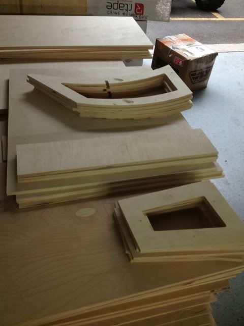

Ya i gave up guys and just squared them all.. I squared 96 sheets of BB and my back is killing me lol.. These 5 foot wide sheets are in some way more difficult to handle because my arms dont want to stretch that far :oops: being shorts sucks! this saw does make quick work of them though :)
I just added another 10 more T60's to this build so Im flat packing them so they will be ready for assembly when I get a little closer. These suckers take up a lot of space
Im gonna just finish these 2 for now and move on to the DR280 build so I can get that jigged up as well.. I'll build 2 of these as well and I'll flatpack the other 16 of them..

hifibob
Posts: 405
Joined: Sun Jan 20, 2013 5:53 pm
Location: Boston MA
#103 Post by hifibob »
miked wrote:26 T60s. I keep saying that to myself, just to try and wrap my head around not only what all 26 would sound like at once, but at the sheer amount of wood you have to cut! Ho-lee-crap, that's a LOT of wood! 96 sheets of BB. You probably bought out the entire tri-state supply of the stuff! LOL!
How did you go about squaring up the sheets of BB? I made the mistake of assuming that BB was square right from the lumberyard b/c it's "good, expensive wood." Halfway through my OTop build I realized how wrong I was but at that point I had to fix as I went somehow. It all turned out fine, but lesson learned for me there.
And hell yeah; 5'x5' sheets of BB are a major PITA to wrestle around by yourself. That sliding panel saw you have makes it tons easier though. I set up 4"x4" studs on the floor and use my circular saw guide to rough them to size...typically about 1/2" larger than I need and I final cut it on the table saw. Wastes a lot of wood that way though.
Good luck and keep them pics coming.
I would love to hear them all at once!! They are gonna be divided up between 5 different dance floors.. Although I do have plans in the near future to build an outdoor system for larger areas, but first things first lol..
squaring the sheets is pretty easy using the the cross cut fence on the slider.. I first put factory edge against fence and square one corner then spin it to do the next then 1 more time. the last 2 cuts are against the stopper set at 59.5"..
I'll have some more pics tmrw. My Duratex came in so Im going to build 4 at a time do too space reasons..

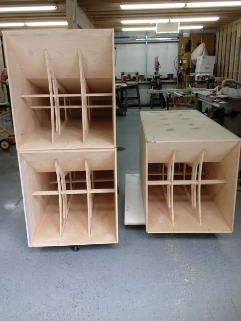

so I been back in the shop and started assembling more cabs.. Now that I have everything flat packed It looks like I can assemble 1-27" t60 and get 1 coat of bondo on in about 8 hours.. AND THE GOOD NEWS I'VE GROWN TO LOVE PL!!
