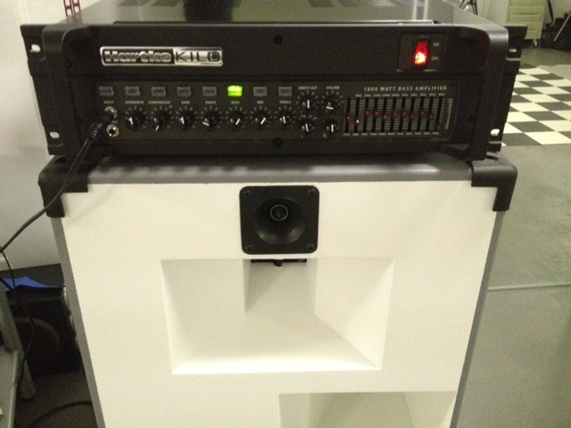

Nice!!! Is the sound rattle free now?Rickyvt wrote:Look what I got for Xmas
A case to match the cabinet and you'd have the sexiest bass combo in Belgium!!!
Re: Omni 15 Tallboy - my first build
Yeah the rattle is completely gone. It was a combination of an active bass and the combo-amp I was using that could not handle high input. I just never noticed it with the combo. This Hartke Kilo is great with the Tallboy. My bass is sounding better than ever!
I agree on a similar casing for this amp, but it has vent holes left, right and on top, so I'm afraid of heating problems...
EDIT The main culprit is my Boss GT 6B - some settings seem to produce the rattle.

Yeah go the matching case for the amp! Make holes to suit the venting, maybe larger, and from the front it'd look just the same! No one would ever know - it'd look wicked up on a stage.

Mmmmm... tempting. I might just do that! This friday it's my first rehearsel with this amp. I'll check its temperature afterwards. Maybe it's not getting all that hot anyway...

Since it has rack ears, it was designed to go in a rack. Just leave at least 1/2" airspace on the sides.....it should be fine. If you want to build it without airspace, then certainly put air vents in the sides.Rickyvt wrote:Mmmmm... tempting. I might just do that! This friday it's my first rehearsel with this amp. I'll check its temperature afterwards. Maybe it's not getting all that hot anyway...

Best if there is a natural convective pathway sympathetic to the venting and/or internal fan. Some fans draw from side and others from the rear, hot air rises, you're a sharp cookie, you'll figure it out.
I allready have a design in mind. It will have to wait till next year though. Happy New Year!
