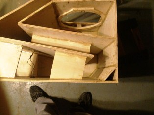

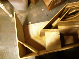

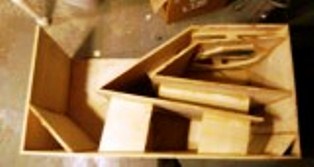

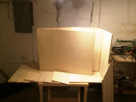

Been silent for a while, but I haven't been sleeping. Got a few things done. Sorry for the wait!
Dont forget, there's eight of these going on!

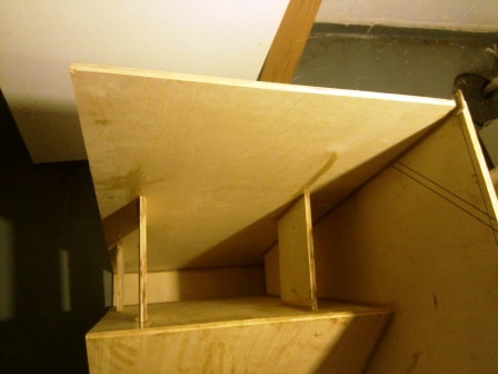

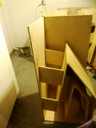

Slowly but shurely, putting panel 9 and the bottoms on now (panel 10). Thus far this has been a very enjoyable proect. Although I should have been done last month....Im getting too many coals in the fire. :horse:

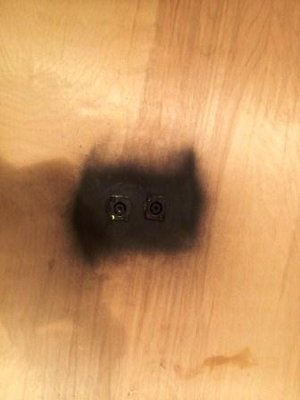

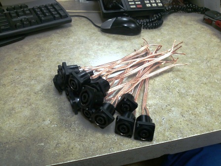

I'm sorry to tell you this so late, but your speakon connectors are the wrong type. You used the type that are supposed to be mounted on steel or plastic jack plates. They will most likely pull out of the wood due to being screwed in so close to the mounting hole. The good news is it's an easy fix. Just order some steel jack plates from Leland along with the mounting screws. He can hook you up and get them to you quick.
This is the one you should have used.
These, minus the actual speakons, are what you should use.
Ryan A
Posts: 867
Re: Titan 48x8 build
#100 Post by Ryan A »
I've used the small speakon jacks before on wood as well. Instead of relying on the screws alone, I layed a generous amount of PL on the wood cutout and then pressed the speakon jacks in, then screwed them in and wiped off the excess PL. They haven't come loose yet. The metal jack plate is the more secure option though.

The PL around the Speakon is a good idea, though if the jack ever went bad (highly unlikely), you'd have to cut the whole thing out. I am in the same boat with the 4 OTops I'm building. I didn't want to deal with having to recess the big jack plate and spending the additional money on it, and just went with countersunk holes like this:
However, the screws I have for the Speakons are the proper #4 size and they are 1/2" long, so they will get a very sold bite on the mounting location. Should be just fine.
So I guess I've got to think about possibly PLing mine in as well. The plan was to just put bathtub silicone on the inside of the panel, all around the jack. That would seal it up and give some additional holding strength. I might go with that and see what happens. Worse comes to worst, I wind up cutting a hole for a proper jack plate.

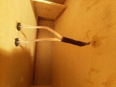

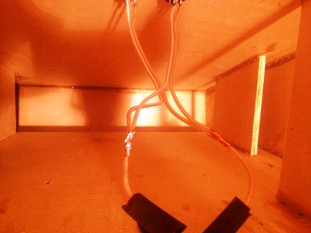

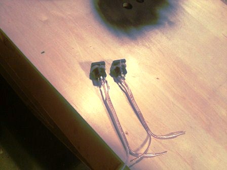

it has been very helpfu throughout thi throughout this project I shoul I should have used the bigger jacks honestly the thought never crossed my mind I had these laying aroond so I use them , i sealed them with pl too, i think they will be ok. the real question is whether or not i wired the jacks together properly. if you refer to my earlier pics youll note that they are wired pos to pos and neg to neg or in para, shouldnt they have beem wired in series or did i do it right. seems if i daisey chain two together my ohms will double not half. thoughts? :fingers:

So you have two Speakons in each cab, correct? And only one driver in each cab, correct? If you wired the +'s together and the -'s together from both jacks, you have wired them for parallel wiring. Hope that's what you wanted!
So, if you have them wired like above, and your drivers are 8 ohms each and you connect:
Amp--->Cab 1 first speakon--->Cab 1 second speakon--->Cab 2
You then have a 4-ohm load.
Hope this helps.

yeah thats what i wanted, just didnt seem right for some reason. thanks miked!

chenry78 wrote: i sealed them with pl too, i think they will be ok. the real question is whether or not i wired the jacks together properly.
A little too late, but this is exactly why it's not a good idea to PL anything that you might have to remove for servicing. In the future, if you do put the jacks on a dished plate, or even fastening the jacks directly to the wood with screws, ensure you have about a 4 inch loop of wire inside so the assembly can be pulled out and away from the box for soldering, etc.
