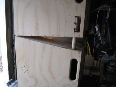

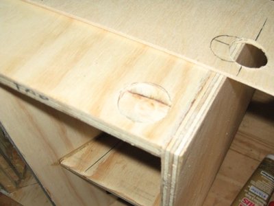

Re: DR 200 build, yep even the shameful pictures

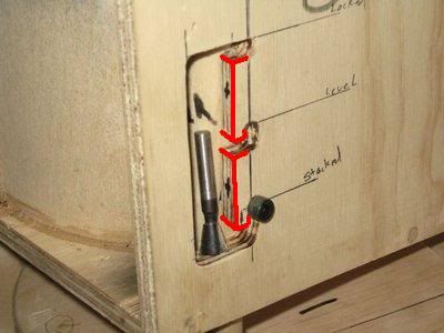

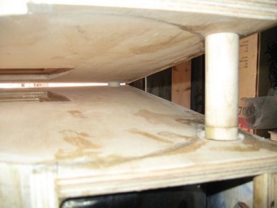

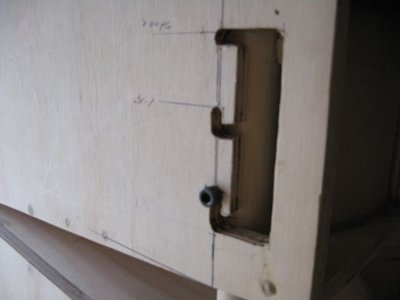

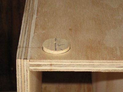

The bottom cabinets just got a coin's (1/8 inch maybe) thickness pellet cut to the right angle and surface glued on the front foot's location. As per quick foot template made from 1/8" ply. I marked one side top and the other side of it "bottom" to also locate the recesses needed.
The funny thing about making a template and then marking the cabinet, is that the first thing to disappear from the work surface under the router bit is that oh soo carefully drawn circle. I'm glad I planned on going bigger anyway.
So, with that little height increase, just a thin layer of 1/8" sheet rubber or even the 1/8" baltic birch addition to the already complete rear legs,will keep the "level" mark in the notches true.
Then on the upper guys I installed a half inch thickness scrap into the routed recesses (no angle cutting here) the recess is angled. Then sanded them down to get an even 3/8" elevation from the table saw deck. Then cut four more to that 3/8 " measurement to add to the rear legs. (remember the level slot is already cut in the adjuster)
Now repeat the procedure for stacking and extend the added on to dowel to the surface of the recess in the lower cabinets' top. Mark bottom of cab on extended dowel.
Measure from bottom of cab to original dowel's length and transfer that measurement onto elevator gauge, (from "closed" or "retracted" marking line). Drill / route additional stop to join to rest of movement channel.
Reinstall dowel, lock in new position and mark extra length at top for removal. Cut, reinstall, lock into "level" position and install interior angled brace, glue, clamp.
I was fighting the springboard and then it dawned on me to just lay them face down on the deck of the table saw for the alignments and measurements.

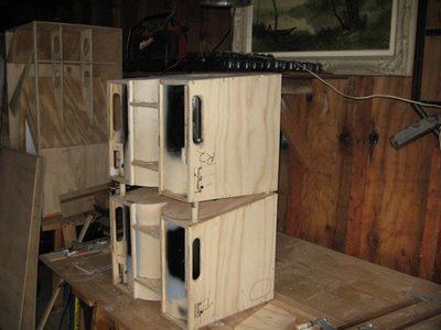

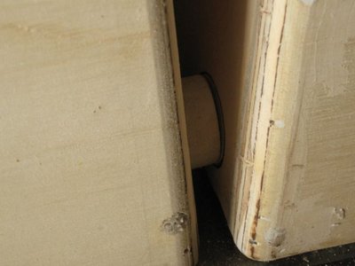

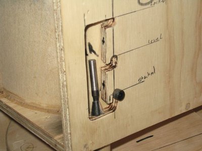

Here's a close up of the channel with stops, FINALLY complete. The surfaces with the + sign are the only ones trimmed back with the bit shown. One one stack on the bench and the other on the table saw. They work really nice and now with the levels worked out, I think just painting the dowels and duratexing the bottoms and recesses with the rest of the cabinet will eliminate me having to buy any glides or anything.
A good portion of yesterday was wondering if I measure to the new extended part of the rear dowels or to the original length. I marked the dowels extension twice before realizing that I had to compensate for the new front legs also or the "level" notch would be off. The elevation to the front had to be incorporated into the length of the rear's also! And the closed position now has all legs about 3/8" exposed... like rubber feet would be if it had 4 of them screwed on.
The last question you really have to ask yourself when starting something like this is... do I have more patience to spend or an extra 150 bucks for two more speaker stands.
Nice.
This doesn't look like Baltic birch, and even if it was I would fear for those delicate edges of the bolt slots (marked red):
One option I would recommend for strengthening these corners is simply soaking them with Super-Glue (AFTER all fitting and sanding is done)
Curing of the Super-Glue can then be accelerated by applying water vapor.
