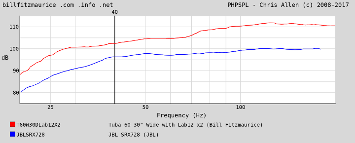

Been a little slow around here, thought I might share a couple easy calculations for you guys to play with.
To calculate the resultant power (watts) after 1dB increase multiply the initial figure by 1.2589. For a 1dB decrease, divide by 1.2589.
Example: How much power will it take to get a 1db gain if you're running 500 watts? 500 x 1.2589 = 629.45
To calculate 2dB you can just run that equation a second time, 629.45 x 1.2589 = 792.41. Or, if you know you want to know what 2dB (or any number of dB) will be, the formula is simply 1.2589 to the power of the number of dB you wish to calculate times the initial power figure (or the initial power figure divided by the product of 1.2589 ^ dB to calculate a reduction).
1.2589^2= 1.5848 x 500 = 792.41
Any number of dB... four and a half dB more than 500watts? (1.2589^4.5)x500= 1409 watts to achieve the 4.5dB gain.
The impedances of these cabs are similar enough for loose comparison. The two traces look to be about 6.5dB apart at 40Hz. If the T60 is on the limiter (800watts) at 40Hz, how much power would the JBL require to match it's output? 1.2589^6.5 = 4.4662 x 800w = 3573 watts for the 2x18 JBL to match the 2x12 T60's output at 800 watts (at that specific frequency).
