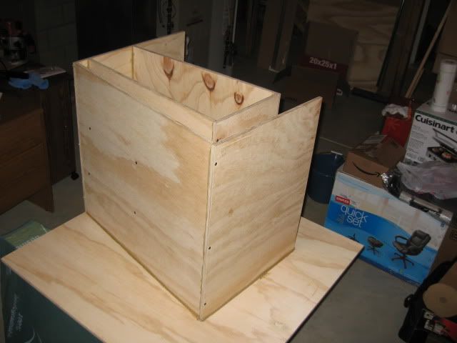

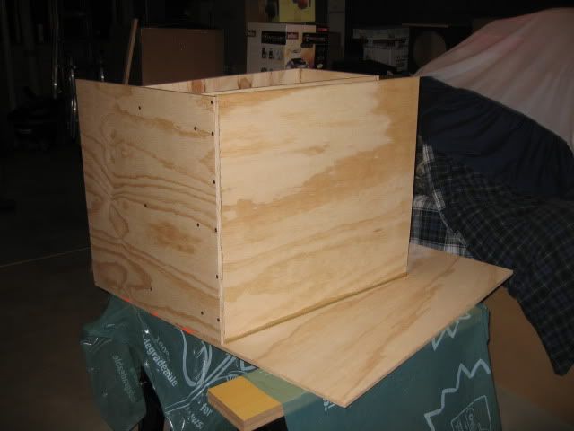

[== 6/23/2009 ==]
Panel 4 is now done. I managed to get the panel flush against the ajoining panels with a little muscle, clamping and screwing.
Regarding Panel #5. The plans only call for an angle cut on the front With a straight 90 degree cut on the back. Looking at the SketchUp drawing it appears like there should be an angle cut on the backside as well. Can someone confirm?

#78 Post by maxmercy »
Since all the angles are less than 10 degrees, I used all 90 degree cross-cuts, like the plans say you can, and made sure to 'caulk' well for any air leaks...but I also used a brad nailer, instead of screws...

#79 Post by myn »
hrm. My plans don't state that. Like you said though. All of the angles are < 10 degrees so not a big deal. PL fills gaps so well.

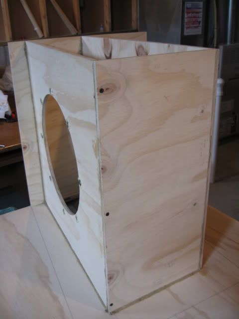

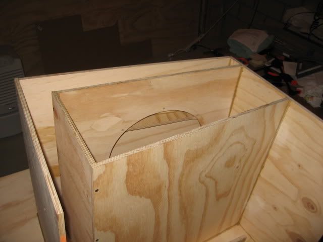

[== 07/04/2009 ==]
Panel 5 installed. Going to cut out the braces and Panel 6 tomorrow.

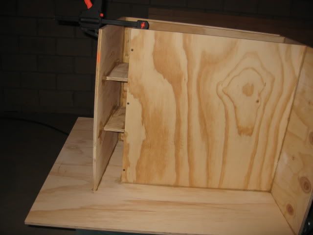

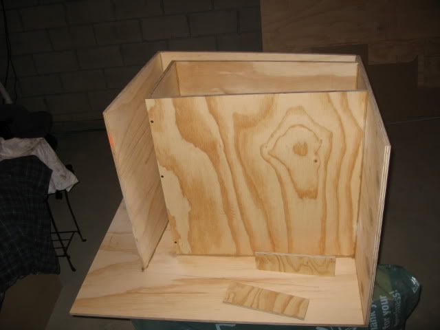

[== 7/05/2009 ==]
I cut out the braces for panel 3/5 (under the driver) as well as panel 6 and it's braces.
I am noticing that the braces don't fit in between the panels as clean as I would have though I attribute this to the warped panels. In some cases they fit good towards the front of the brace but may be out an 1/8 towards the back and vice versa. Is that common and to be expected? Should I just use a heavy dose of PL for them? The plans say to just make them fit snug without bowing the panels. I'm not sure how I'll be able to get them in tight without a little twisting.
Thoughts?

#83 Post by Rickisan »
However much the brace is too small on one end... cut an equivalent amount off the snug fitting end along a line ending at the existing "too small" dimension and the brace should fit just right. This is hard to describe but I hope you understand my intent. I can do a Photoshop if will help.

#85 Post by Tom Smit »
myn wrote:[== 7/05/2009 ==]I am noticing that the braces don't fit in between the panels as clean as .....Thoughts?
Don't know if this is proper but, when building my AT I screwed the brace onto the "exterior" panel, checked for fit, removed and PL'd that edge of the brace and re-attached, then applied a thick layer of PL to the other edge of the brace and attached the panel.

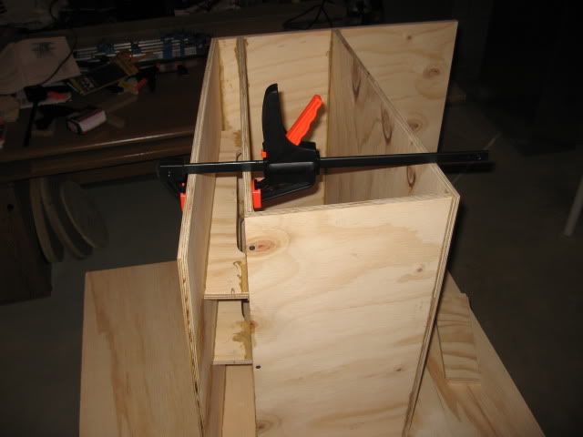

#86 Post by myn »

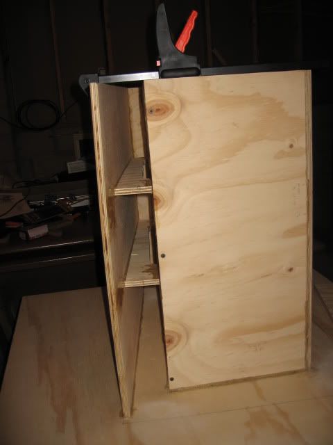

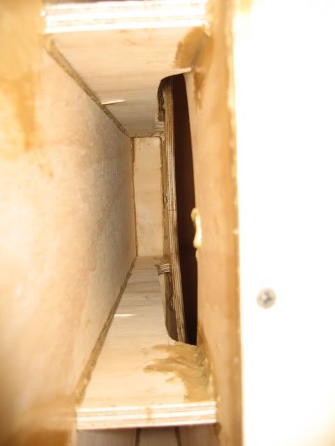

[== 7/6/2009 ==]
Braces between panel 3 and 5 installed.
NUFF PL to fill the gaps.. I felt like I was playing that childs game "Operation" with the braces as I pushed them between the panels. The objective being don't smear all of the PL all over the panel before Its in place. I only managed to screw the braces in place through panel 5. I was unable to get my drill into the access panel to screw them in through panel 3. Lesson learned. Predril braces before securing panels. I am guessing it should be fine as there was lots of PL squishing out and the clamps will hold the braces against the panels

#87 Post by maxmercy »
Lookin' good! The THT plans must have changed since I purchased mine, as mine only have one brace opposite the driver...
I found the most time-consuming part of the whole build to be fabricating the braces...and of course the finishing process.

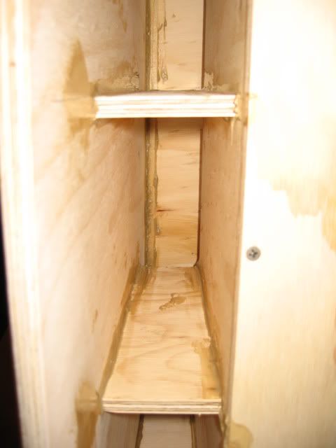

#89 Post by myn »

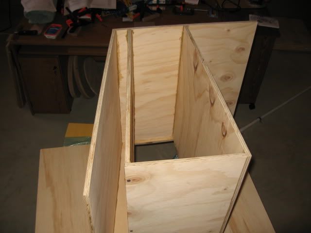

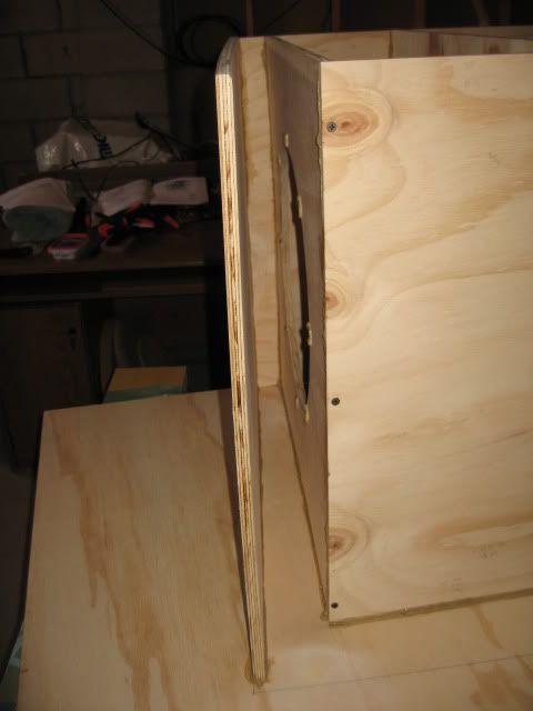

[== 07/07/2009 ==]
Panel 6 now installed. Tomorrow installing panel 6/4 braces and cutting panel 7.
I thought the braces would have been alot easier. Each one so far has needed some tweaking to fit cleanly.

#90 Post by myn »
[== 07/08/2009 ==]
Rickisan wrote:However much the brace is too small on one end... cut an equivalent amount off the snug fitting end along a line ending at the existing "too small" dimension and the brace should fit just right. This is hard to describe but I hope you understand my intent. I can do a Photoshop if will help.
Thanks Rickisan. That little tip helped me out today installing panel 4/6 bracing. Used my jigsaw and trimmed a 16th off one end and it fits significantly better.
I also cut out Panel 7 and it's braces tonight. Seems like I'm finally getting in the groove and its becoming increasingly faster todo things.
Looking ahead to Panel 2/7 brace install, I'm wondering how I am going to slide the braces into place as Panel 1 is in the way. I am guessing I start as far back as I can and very carefully push them into place? This bracing reminds of of that kids game "Operation. In this case the goal is not to get the PL all over your cabinet!
I also am thinking about installing panel 2/7 reflector after panel 7 and the bracing has been installed unless someone can convince me otherwise.
