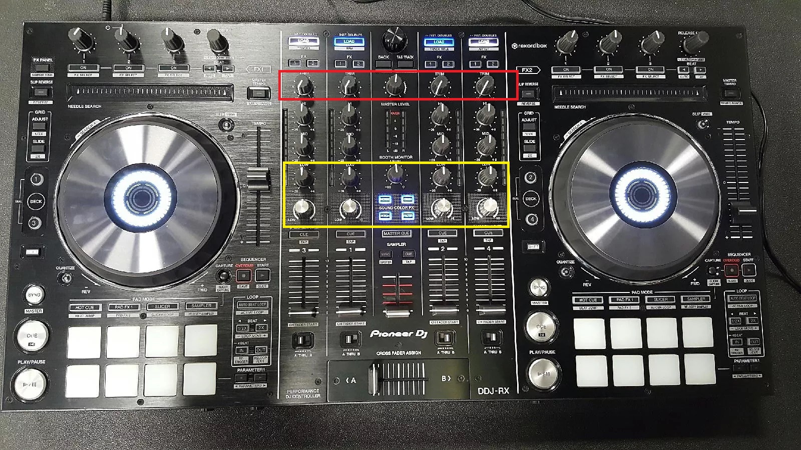

...Question now is, what on earth is the setting that can kill that much of the gain and nearly all sub output of the DDJ-RX?..
- Master Level and Trim knobs (red box). Trim controls the individual channel output gain and can kill the output if set too low. Master Level too.
- Low EQ and Filter/Sound color FX knobs (yellow box) can kill the bottom end. Put all the knobs in the yellow box straight up until you get this sorted out. Matter of fact, put the HI and MID knobs straight up too.
