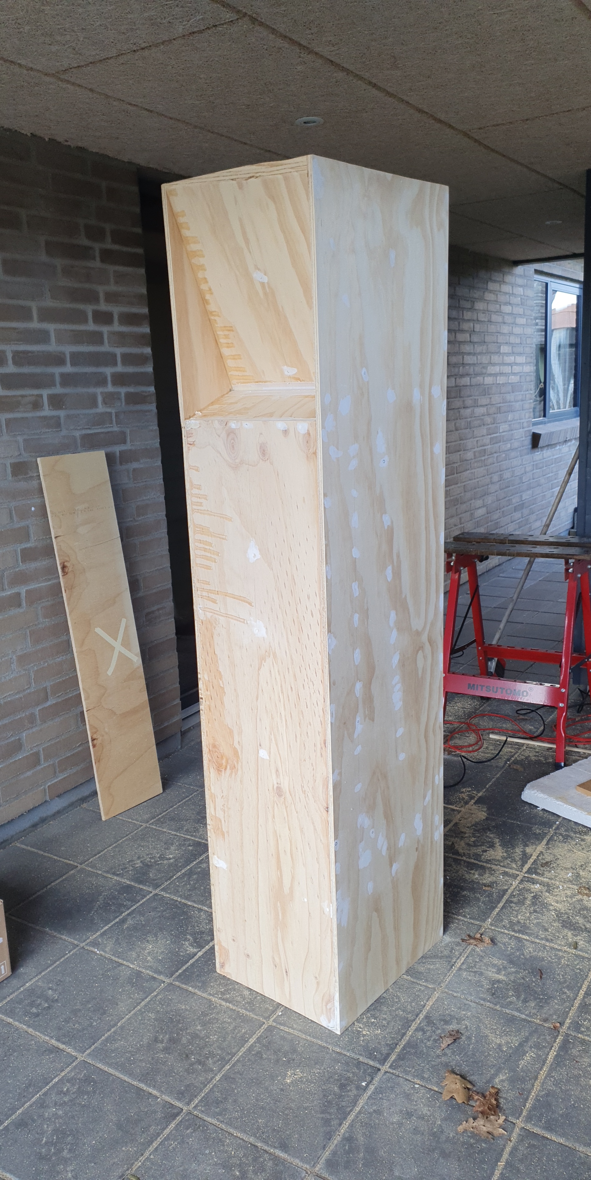

Trust me. When I struggled to carry it in to the living room, I got that look that only women can do. I think only men who build extremely unnecessary things will experience it.
And - this is probably twice the size of what I think is appropriate. But I just need to know what it sounds like.
Like all other build threads, this also does out a bit. Sorry!

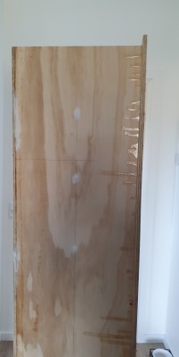

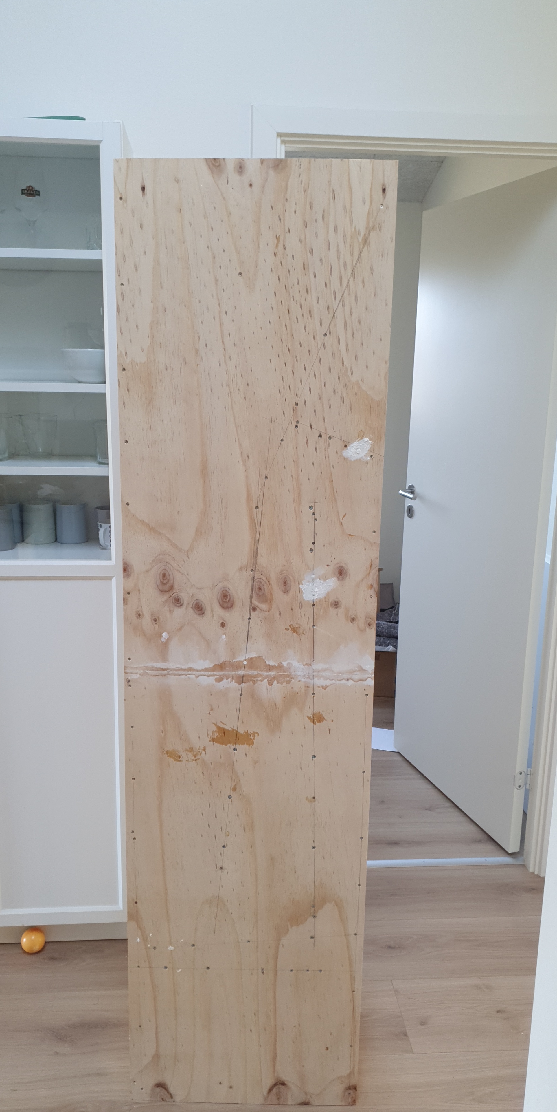

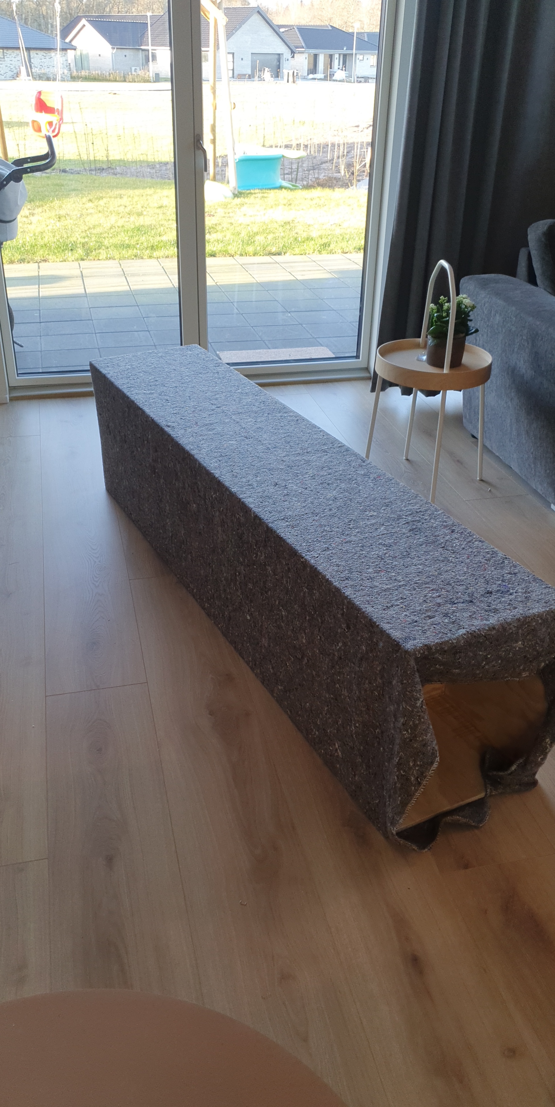

Well. We can call this "The isn't". Because it's not straight in any direction :noob:

How do you plan on using it: laying down or standing up? Or no set plan? If you think it will get used in one orientation most of the time you could carefully belt sand down a bit of the floor facing side at an angle, removing enough of the material to make it lay flat. If there's more to remove than you think is safe, you could glue a strip of 1/4" or 3/8" to the lower half of that side to bring the low portion up, leaving less high side to remove.
JensToft91
Posts: 140
Joined: Sun Feb 28, 2021 6:43 am
Re: Slim THTLP
#79 Post by JensToft91 »
Laid down behind the couch. I'll put it on rubber feet, I think.

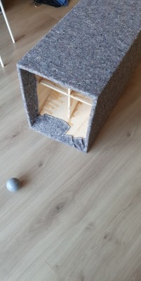

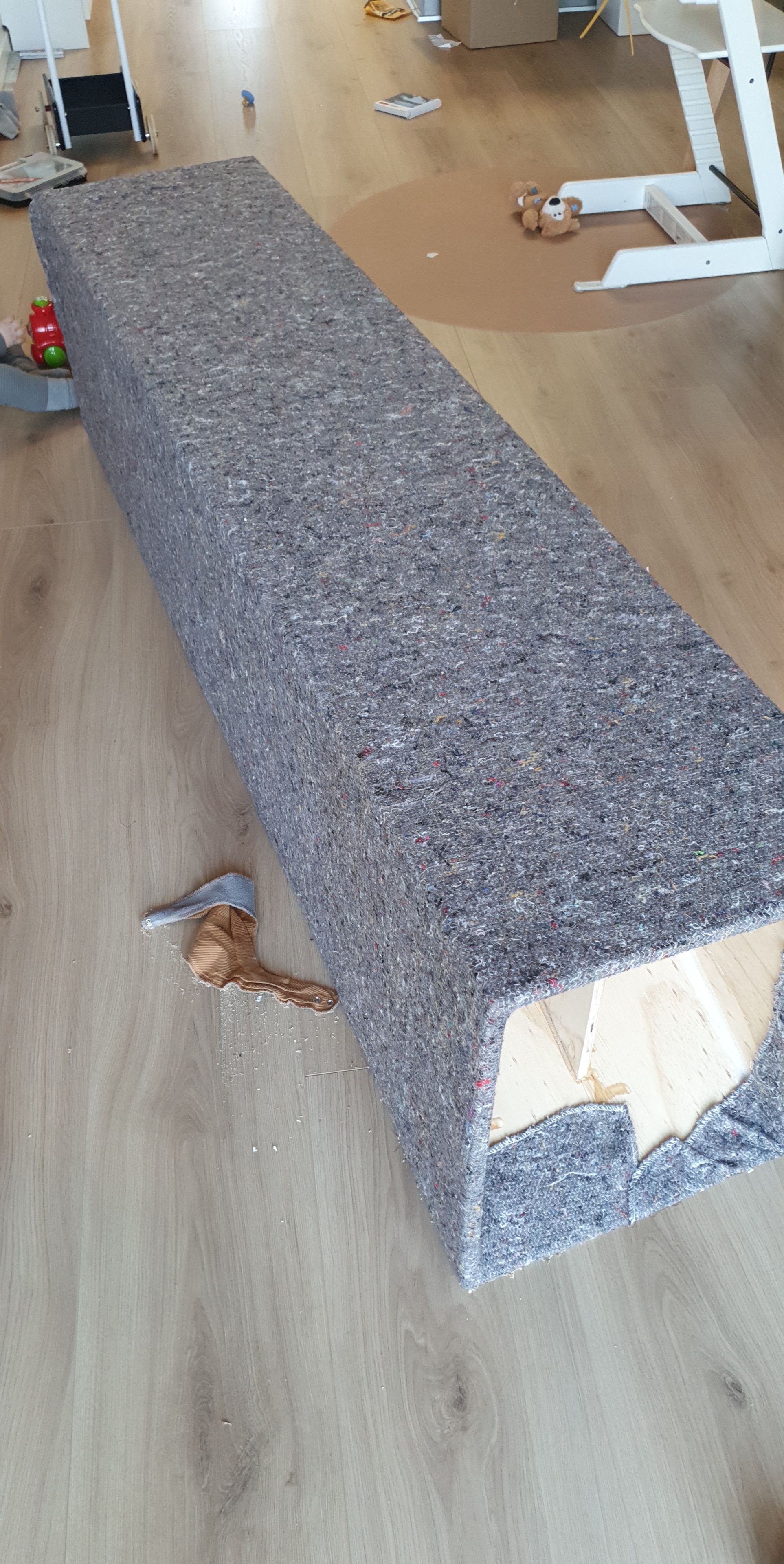

I got this idea. Clamp the rug I used as protection for the floor, and then color it with what ever fabric I'd like.
But that cheap rug ended up looking pretty damn smooth.
I don't know how I'll finish the buttom, yet - but I'll probably figure it out.
I'm simply amazed about how this turned out. A 10 minute job.

Resourceful! You can just run a carpet knife or exacto blade around the inside, an inch or two from the end for a clean border.

JensToft91 wrote: Sat Feb 26, 2022 10:33 amI don't know how I'll finish the buttom, yet - but I'll probably figure it out.
How about: not. As long as it is not rocking or vibrating to the floor, and the floor is consistently dry, you should be perfectly fine with no finish whatsoever. No one is going to sneak behind the couch, flip the thing over and then start moaning like "Hey now listen here Jens, how come this side is not as pretty as the others".
Yep, looks perfectly fine by me. That is, assuming you don't have any cats in the house.
