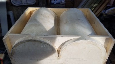

I'm filling in the buttcheeks today. I'll be attempting to make the (almost) square box version. Want to mount my speakons in there, or maybe a recessed dish with jacks in it, have not decided yet.
And don't panic, the foreground ones are just sitting there after belt sanding into submission. I'm glueing them flush like the background ones (nd the other cab, already back in house/heat to cure).

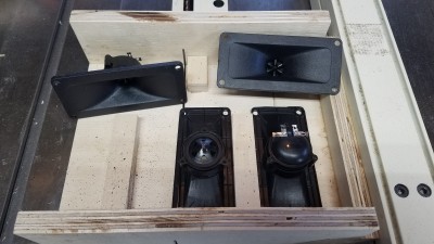

Re: HowieZ DR200 build
Posted: Fri Dec 17, 2021 2:54 pm
by howiez

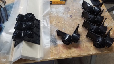

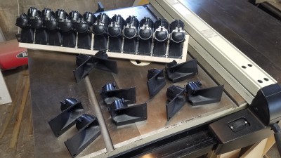

Tweeters are all cut and cleaned up. Bill that tweeter jig is superb. I was about 1/32 proud on the first cut, so I just moved my fence a fuzz and re-cut my jig kerf. It was hard to get my tape in there when i glued the stops apparently. But after another run through, all the first sides cut great. Then it turned out the second cut was perfect at 2" by doing that. I thought i'd have to fuzz my fence back since I cut the slot first and glued the stops in relataion to it.
Same with the 45 miter, I had to sneak jup on it to get the 3-3/8 but I wrote the fence to blade measure on my jig for next time around.
Next time i'd probalby remove all the piezo elements first. two of my corner ones have melty crumbs of ABS rattling in them. I'm about to open them up to clean them out. Hope I didn't melt anything!
Posted: Fri Dec 17, 2021 5:00 pm
by Seth
Howie, you're moving right along! Looking good :thumbsup:
One thing I see; unless you plan to alternate the tab orientation, it appears you may not have cut deep enough. For the standard, by the plans construction, the blade must be high enough to also trim the screw bosses and screw heads. Otherwise, they wont glue up flat. The screw bosses stick out further than 2". If you do plan to do the alternate method, forget I mentioned it... Good to go.
You're really coming down the home stretch!

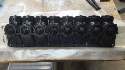

Posted: Fri Dec 17, 2021 9:55 pm
by howiez

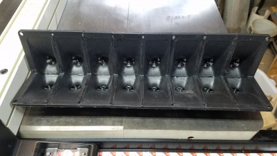

Seth wrote: Fri Dec 17, 2021 5:00 pm One thing I see; unless you plan to alternate the tab orientation, it appears you may not have cut deep enough. For the standard, by the plans construction, the blade must be high enough to also trim the screw bosses and screw heads. Otherwise, they wont glue up flat. The screw bosses are wider than 2". If you do plan to do the alternate method, forget I mentioned it... Good to go.
Funny you should say that Seth, I didn't in fact get high enough. I always thought people were complaining about the two that meet at the middle. They fit so I glued 8 pairs for one array. Then as I started setting them side by side I noticed the bosses are fat on some. I cleaned them up with a sander, but I still have two gaps I need to clean more. I ended up removing all the piezo elements, turns out I may have two bad ones. After cutting two rattled. I thought I had gotten a chunk of plastic in them. Turns out one was made on a monday, the missed clamping the entire diaphragm, so it was wrinkled/folded over and loose. The other one had a HUGE chunk of solder splash in it. We'll see, i'll test them at some point here. I was going to test them for polarity anyway.
You can see gaps in a couple here, they'll need some more massaging. I'll recut the other 16 to make sure that barrel gets trimmed more evenly than my hand clean up.

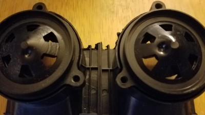

Sage advice. I also wonder how many of the castings are bad. It just so happens my two that made noise also had molding defects inside the lens. The both had a shrink spot where it cooled too fast. There is a pocket the size of a BB pellet in one and the other is closer to a 6mm airsoft pellet sized pocket. I'm thinking i'll cut two new frames because it'll just irk me it's in there.

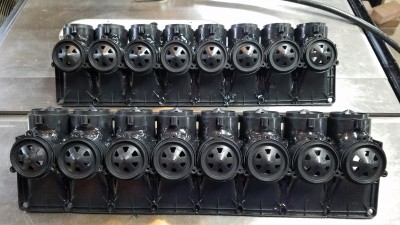

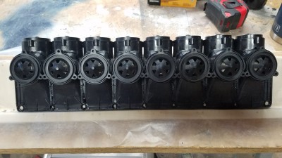

Posted: Sun Dec 19, 2021 10:50 pm
by howiez

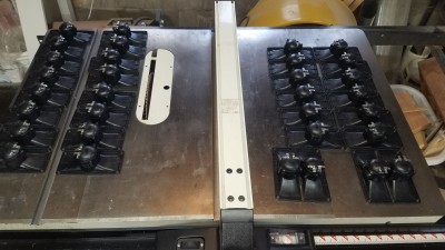

So I cut the second 16 again to make sure the screw bosses were cut all the way. Suprisingly only about half of them actually hit. Seems there are two molds or they slightly twist one mold when setting it up. The one of three screw bosses that would point to the opposite side of the array is not always at 12 o'clock. If you look close, some if the side ones that hit are right in line, and get shaved. Some are twisted/clocked enough they don't even touch. Anyway they are all cleaned up. Next I pulled apart the one joint that was really bad. I scraped at two others that were tight and opened up some clearance. I was temped to take my multi tool and just shave between them, but a utility knife did enough cleanup.
Fun fact i learned this week, if you glue PVC pipe together it does not 'melt' together like I thought. You can heat the joint to between 4 and 500 degrees F and pull the glue apart before the PVC melts or burns. So I tried exactly that, I used my heat gun, set at 500F and warmed the joint that had a gap. I was able to separate it, shave the boss, and heat it up a bit and push it back together. Then I just dabbed a little glue back on the back. My plan was to do the coats of PVC glue, and lo and behold my local menards has black ABS glue in the plumbing section. Not ABS glue for black pipe (ok it is for that), but it is actually colored black. It does not color match perfect, but I thought it looked nicer than the clear stuff (or orange I had) on the black plastic.
I used the black glue on the frames, and it wicked onto the wax paper in a few places where i was sloppy. I'm always sloppy, so it's all over. I'll probalby use my dremel and a little brush wheel to clean it up, and maybe spray bomb them black again. You may also notice some of my sides skewed at glue up. Somehow I got a wrinkle in the middle, and you can see a little wave to the 'mounting flange' Again, heat gun to the rescue. I lowered the temp a bit, between 200 and 500 on my gun, and wamred the offending joint. After 30 seconds or so, I could flatten/flush the pair. I would hold it for 30 seconds or so until it cooled. I was much more careful on my second array so the jig would keep it flat. I'm guessing my bosses hitting did that, pushing things around a bit.
I tried something I saw on the forums here as well. For the layers of glue on the back, someone had an alternate method. They took MEK and put the plastic 'sawdust' in there to make a paste slurry. I actually cut the trimmed strips into 1" lengths and dropped them in a glass jar and let them dissolve for a day or two. I was able to get it to about honey consistency. Then I could take a stick and drizzle a line of it, or kind of brush it on. I can't stress enough to wear a respirator, and I did mine outside/garage open for fresh air and to let the solvent evaporate. It is nasty smelling, but I liked how it coated. I did one side one day and let it cure 24hours to make sure it would even harden and not melt through. It turned out nice and smooth, and they seem very rigid. With that I did the other side, the middle and the whole second array. I made the paste a hair thicker for the second unit so It would dry quicker and not run. I might do one more coat up the middle since it ran downhill a bit.
Last update for the weekend, I wanted to cut my throat fillers to finish the cabinet insides. I made a small template out of a scrap of the 1/8 ply since my woofer is not the recommended one. I think I have plenty of clearance with the standard diameters.
