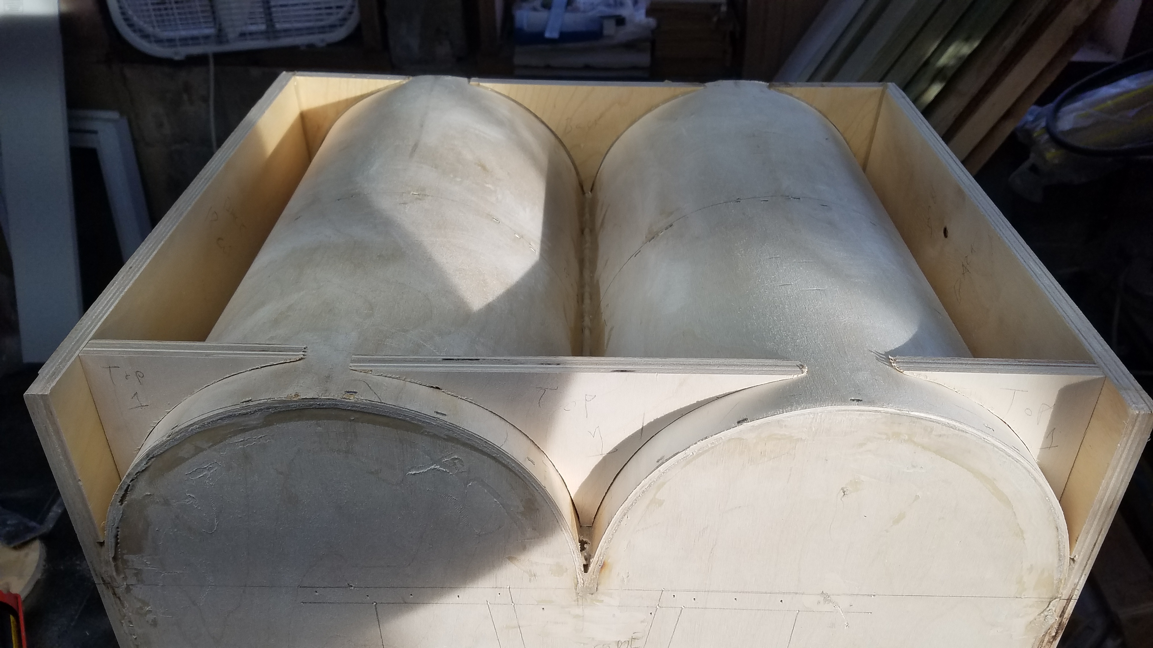

I'm filling in the buttcheeks today. I'll be attempting to make the (almost) square box version. Want to mount my speakons in there, or maybe a recessed dish with jacks in it, have not decided yet.
And don't panic, the foreground ones are just sitting there after belt sanding into submission. I'm glueing them flush like the background ones (nd the other cab, already back in house/heat to cure).

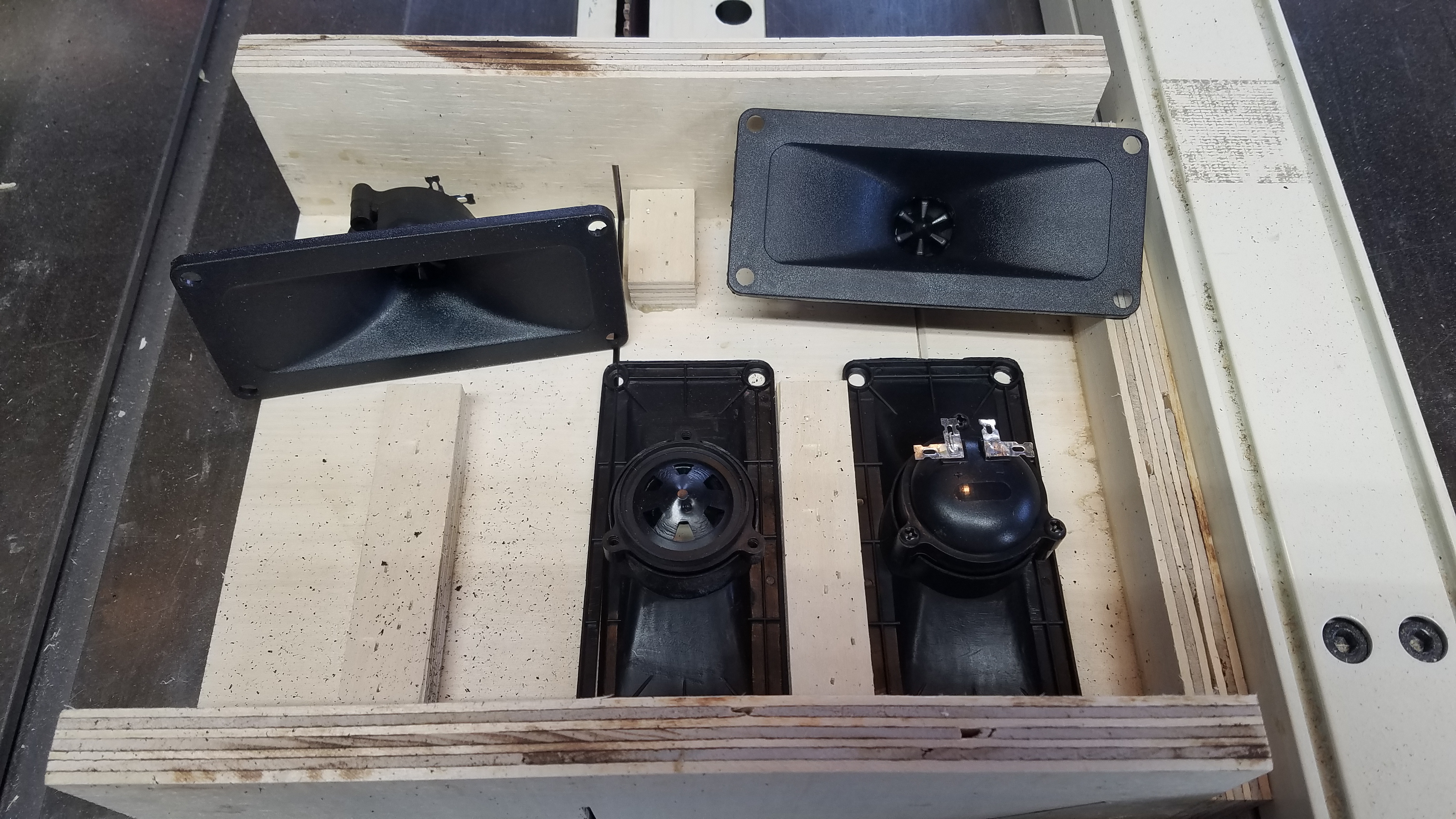

Tweeters are all cut and cleaned up. Bill that tweeter jig is superb. I was about 1/32 proud on the first cut, so I just moved my fence a fuzz and re-cut my jig kerf. It was hard to get my tape in there when i glued the stops apparently. But after another run through, all the first sides cut great. Then it turned out the second cut was perfect at 2" by doing that. I thought i'd have to fuzz my fence back since I cut the slot first and glued the stops in relataion to it.
Same with the 45 miter, I had to sneak jup on it to get the 3-3/8 but I wrote the fence to blade measure on my jig for next time around.
Next time i'd probalby remove all the piezo elements first. two of my corner ones have melty crumbs of ABS rattling in them. I'm about to open them up to clean them out. Hope I didn't melt anything!

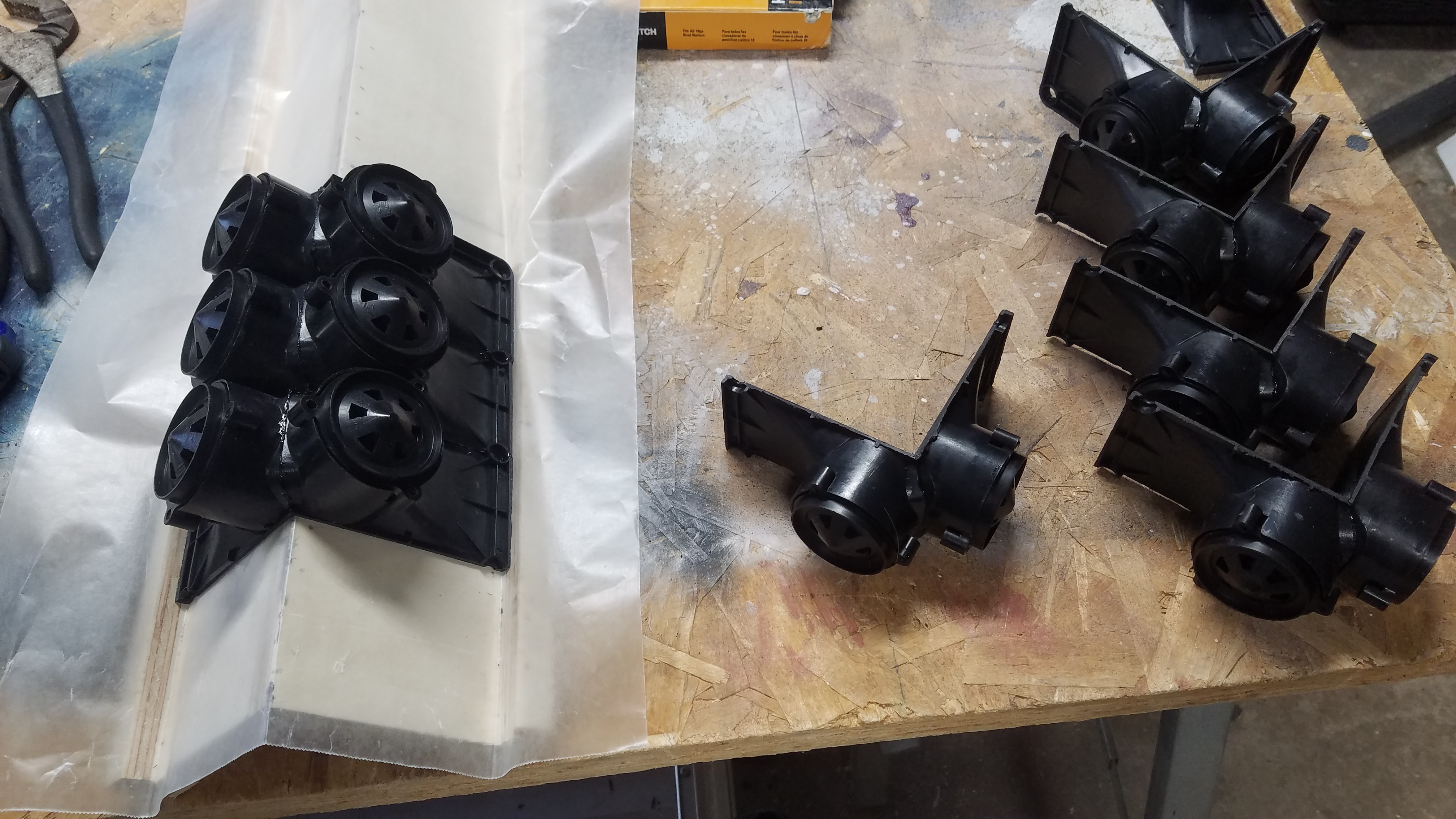

Howie, you're moving right along! Looking good
One thing I see; unless you plan to alternate the tab orientation, it appears you may not have cut deep enough. For the standard, by the plans construction, the blade must be high enough to also trim the screw bosses and screw heads. Otherwise, they wont glue up flat. The screw bosses stick out further than 2". If you do plan to do the alternate method, forget I mentioned it... Good to go.

Funny you should say that Seth, I didn't in fact get high enough. I always thought people were complaining about the two that meet at the middle. They fit so I glued 8 pairs for one array. Then as I started setting them side by side I noticed the bosses are fat on some. I cleaned them up with a sander, but I still have two gaps I need to clean more. I ended up removing all the piezo elements, turns out I may have two bad ones. After cutting two rattled. I thought I had gotten a chunk of plastic in them. Turns out one was made on a monday, the missed clamping the entire diaphragm, so it was wrinkled/folded over and loose. The other one had a HUGE chunk of solder splash in it. We'll see, i'll test them at some point here. I was going to test them for polarity anyway. You can see gaps in a couple here, they'll need some more massaging. I'll recut the other 16 to make sure that barrel gets trimmed more evenly than my hand clean up.Seth wrote: ↑Fri Dec 17, 2021 5:00 pm One thing I see; unless you plan to alternate the tab orientation, it appears you may not have cut deep enough. For the standard, by the plans construction, the blade must be high enough to also trim the screw bosses and screw heads. Otherwise, they wont glue up flat. The screw bosses are wider than 2". If you do plan to do the alternate method, forget I mentioned it... Good to go.

So I cut the second 16 again to make sure the screw bosses were cut all the way. Suprisingly only about half of them actually hit. Seems there are two molds or they slightly twist one mold when setting it up. The one of three screw bosses that would point to the opposite side of the array is not always at 12 o'clock. If you look close, some if the side ones that hit are right in line, and get shaved. Some are twisted/clocked enough they don't even touch. Anyway they are all cleaned up. Next I pulled apart the one joint that was really bad. I scraped at two others that were tight and opened up some clearance. I was temped to take my multi tool and just shave between them, but a utility knife did enough cleanup.
