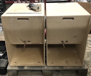

Wee bit of progress. Got them buttoned up, trimmed off the proud edges and rounded everything over. I used a jig saw to trim the edges close, then a router against a straight edge to finish them off. Worked great. Maybe will try and fill and paint this weekend. Ribs are still a mess from the accident but everything else is feeling much better.

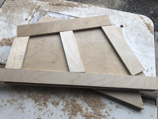

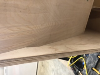

Raining outside, so will hobble around in the garage and see what I can get done. Here’s some pics of where I’m at for now...

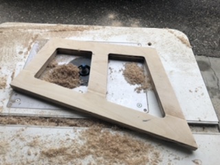

Using Leland's trick of pinning some strips and using a pattern following router bit to lighten the big braces. Takes a little time, but much cleaner and prettier than with a jigsaw like I did last time. Great tip, Leland!
Also doing what I did on my first two tubas, as well as my j-arrays, in laminating 5/16" 6-ply BB strips to the outer edges of the mouth. Totally unneccesary, but I like the look of heavier construction, but without actually using 3/4"+ ply (and the weight that would come with it).
Also, I made the big braces by laminating two pieces of the 5/16" stuff together. All the inner braces were just single thickness. With everything being BB, they're ridiculously rigid.

- Posts: 8664
Re: Things that go boom
You do realize that no one will ever see 'em, right?himhimself wrote: ↑Sat Apr 24, 2021 11:26 am much cleaner and prettier than with a jigsaw like I did last time.
himhimself
- Posts: 645
Inside, sure, but the the big 6/12 braces at the bottom are visible. Now, whether anybody really looks is debatable, but I know I will
I actually didn't even bother with putting any cutouts in the internal braces this time, except for the 1/10, which I just hacked out with the jigsaw. Figured the internal braces were 5/16 instead of 1/2, so already lighter. The front of the big bottom braces end up being grab handles when moving them around, too, as didn't put any handhold cutouts in panel 12.

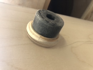

Risers with rubber feet to match the height of the rear casters. I love these, have used a ton of them. Super chunky and solid. And cheap. 8 pack on Amazon from reliable hardware is usually about $5.

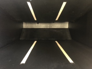

Just rambling while waiting for some flat black latex to dry on my big braces and the cab mouths. I put down some strips of tape where the braces will go. That way I can roll the Duratex in there without the braces in the way, pull the tape and then PL them in place after.

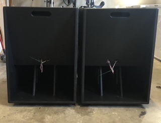

Pulled the tape, exposing my “landing strips” for the braces. Entire cabs covered in flat black, innards and bottoms have a coat of duratex. That’s it for today.

Oh, I've thought plenty about it. Those big angled front panels are ripe for cool routered-in designs. I just can't make up my mind what I'd like to put there. I even considered putting some t-nuts behind that panel, so I could attach whatever kind of logo the occasion calls for. And rotate them depending how the subs get positioned. Too much thinking...

- Posts: 8664
I like mine to be in "stealth" mode. Just black boxes that no one can see into. Then, they have to ask.himhimself wrote: ↑Sun Apr 25, 2021 5:29 pmOh, I've thought plenty about it. Those big angled front panels are ripe for cool routered-in designs. I just can't make up my mind what I'd like to put there. I even considered putting some t-nuts behind that panel, so I could attach whatever kind of logo the occasion calls for. And rotate them depending how the subs get positioned. Too much thinking...![]()
I agree, it's so very nice when they start looking finished, and yours are looking goodhimhimself wrote: ↑Sun Apr 25, 2021 11:49 am ...I think I'll see if I can finish one of the most satisfying parts of the build - putting on the Duratex.
Personally, I find flush trimming and rounding over the most satisfying though. For me, that's when my cabs go from looking "eh" to "yeah baby!"
By the looks of it, the neighbors should be getting a treat within the next day or two.
