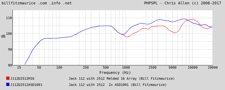

This chart shows the difference in sensitivity between the compression driver option and melded array. Obviously, the melded array has the benefit of better off axis response. But, the compression drivers are considerably more sensitive.
I'm curious how that plays out in actual power consumed to make equal output, as the piezo drivers are reportedly a capacitive load and require very little power.
I wonder whether the ASD option or melded array would better utilize battery life in this case. Bill, is there any insight you can offer?
- Posts: 29056
Re: Bought a bunch of plans still haven't built anything...
The high impedance piezos use perhaps 1/10 the power that ASDs do.
