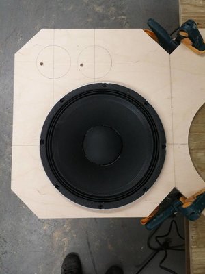

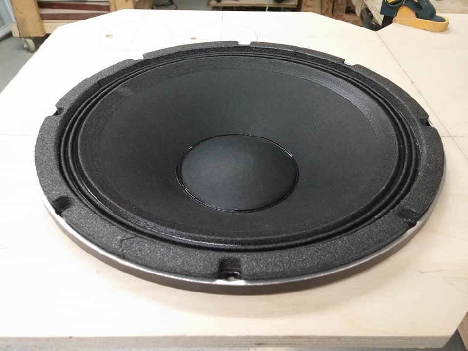

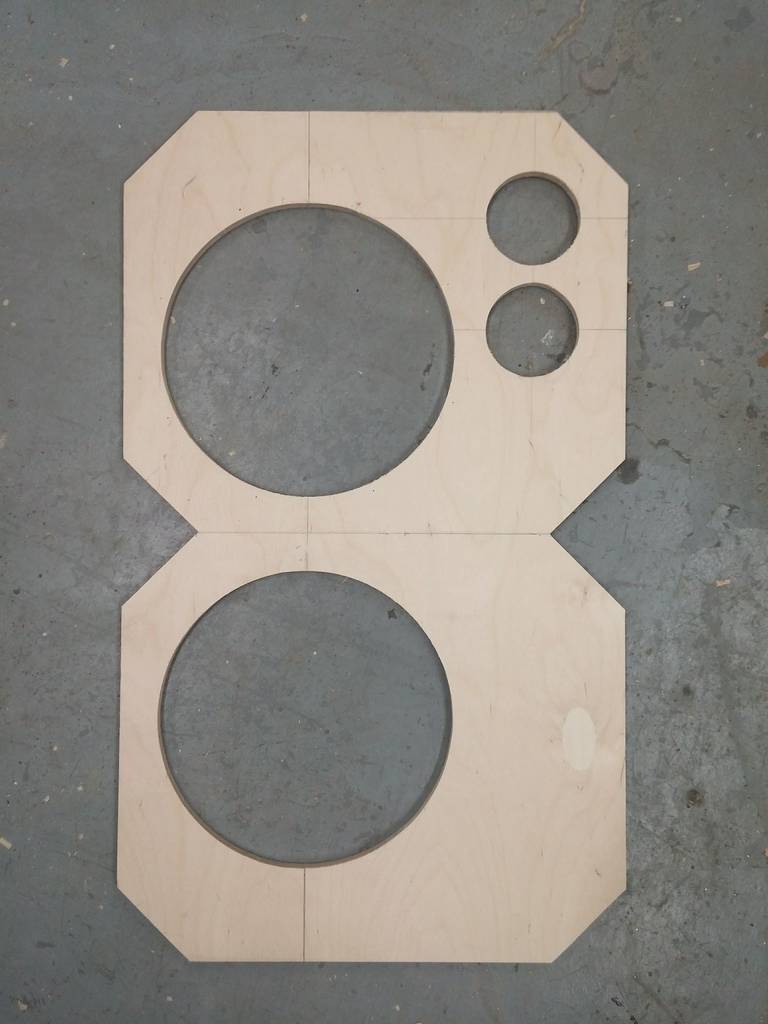

So it uses 3012lf, datasheet says 11.06" hole in the baffle right?
Because i did that at exactly 11.06" and when fitting the speaking in the hole i can move it around a bit in the hole, it's normal that it is a bit bigger than a perfect fit?
Thanks!

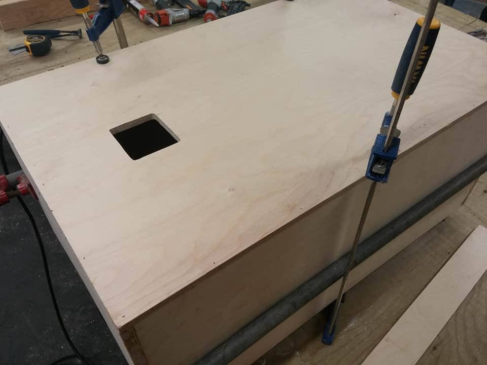

#86 Post by Electric Wisdom »
The back is 1/8 off on one side but i'll sand it to make it good, hoping the baffle will fit inside, i did a fit test, seems good but let's see tomorow.

#87 Post by Electric Wisdom »
It's all dry now. Damn that glue is super strong haha :hyper:

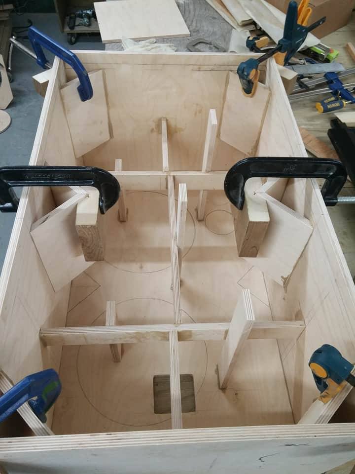

#88 Post by Electric Wisdom »
Ok it's completely wrong compared to the workflow on the build guide but my helper suggested installing the back first so yea i had to measure everything to the end reversed, looks like it fits well tho... i won't be as easily distracted for the second cab loll #RULE1 haha ;)
Posts: 7588
#89 Post by Tom Smit »
There is a reason to do the baffle first, but, it looks like you found a way around that judging by the pencil marks on the back panel. :clap:
Posts: 28955
#90 Post by Bill Fitzmaurice »
There's another reason. Doing the baffle first you can see the joints of the baffle and ducts. It's critical that they be airtight. Now when he attaches the baffle he can't tell if they're airtight, unless he happens to have a gooseneck mounted camera to look inside the cab. He'll also have to install the damping working through the speaker holes, a royal PITA.
