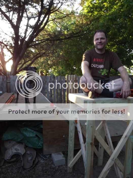

I built a pair of these stands since I opted to not put top hats in the cabinets and I intend to build a second pair further down the road. I decided to test the stand by sitting on it and it worked fine, and I'm not all that slim... so there will be no problem for these to hold up a pair of O-Tops each. The stands are quite stable with the speakers on them. I think my dog was itching to jump on there with me but I don't think that would have gone very well.

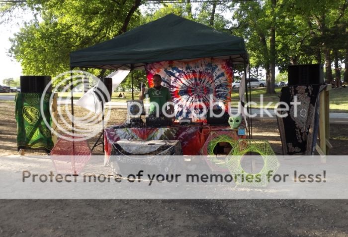

That's me playing a set on my full system at a park party I just threw. I opted to design and build my own vented subs due to easier build and smaller pack and storage space required versus tubas. In the future I will probably build a shed to store the system and then I can build the tubas. At any rate, the system as a whole sounds good and I got compliment after compliment with many specifically commenting on how clean the O-tops sound and look. Some of my DJ friends insisted on redlining the mixer

Great finish. Playing psytrance? decor somewhat suggests that
Bet the high end is appreciated with said music
Re: Pair of OTop 12s with Delta Pros
Yes, a day of psytrance indeed! One of the best aspects of the party is that we had the system pretty much facing the track for the miniature train that goes through the park and it was a busy day with packed trains going by all day. Some of the train-riders just stared with some noticeable slack jaw. Some were fist pumping and getting into it. One family enjoyed it from the train so much that they came over after they got off the train and momma proceeded to dance her butt off. It was a lot of fun... and all those whizzy psytrance sounds were great on the O-Tops for sure!

1. Are your stands collapsible (do they come apart for transport?). It doesn't appear that they do, but thought I'd ask anyway. I would really like a set of STRONG and stable platforms that come apart. See member Pulseman's STEEL stands...I will have a set like that built one day. I opted to not put tophats in my OTops either and though I came up with a safe and strong mounting solution, it is a time-consuming PITA to set up.
