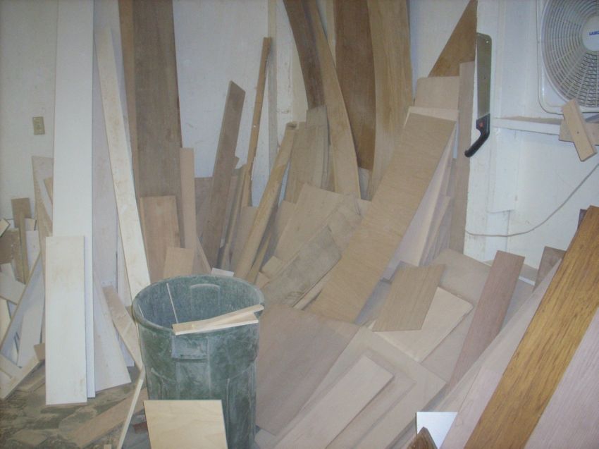

Time to stretch my boards.
The edge that needs to get bigger is already at a 22.5° angle, so I need some wood cut at that angle.
Alder or poplar are a good match for the Baltic birch we use.
Avoid open pore wood such as oak and ash, this is especially true for my situation where I am doing a smooth painted finish. Also avoid soft woods (pine, fur, etc.) as they will ding much more easily. Really hard woods like hickory are just a bear to sand and really add to the work.

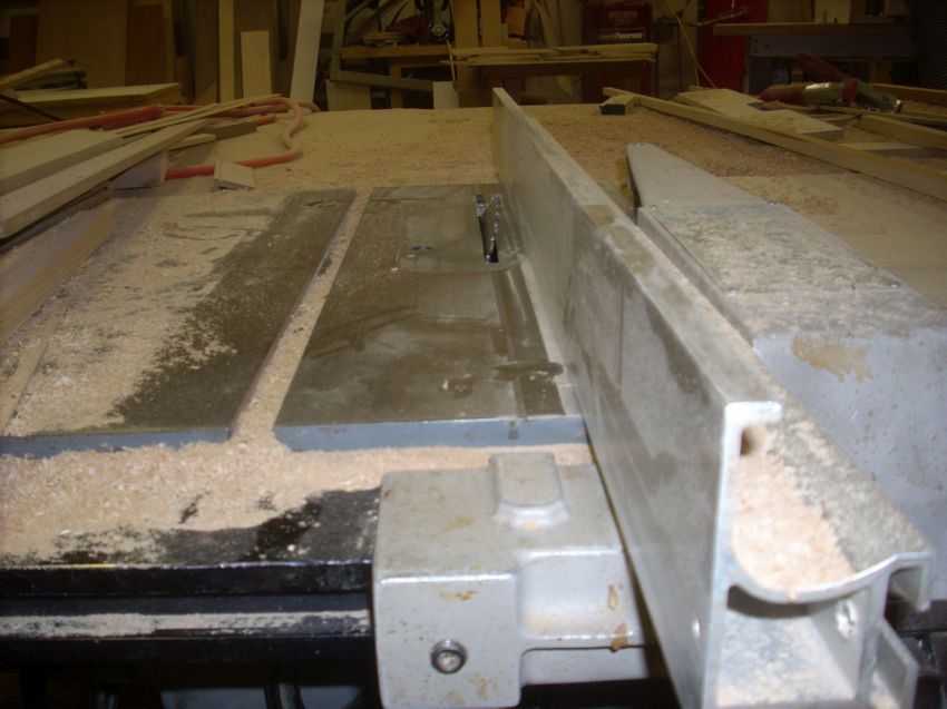

After carefully cutting out some angled edge material, it was cut a little long and the end that meets up with the base has to be sanded at a slight angle to improve the fit.
So far so good, but how to clamp it on where we have angled edges that will slide past each other when pressure is applied to the clamps???

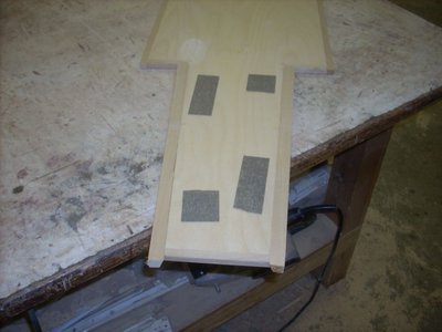

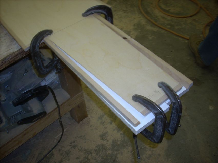

Here is what I came up with:
First, put some thin spacers on the side of the panel that is narrower (the side that the edge will want to go up over when clamping.)
I used some formica scraps.

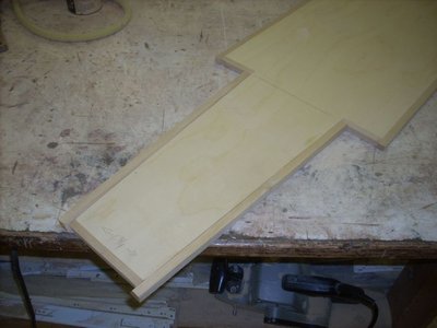

If you look carefully at the picture above, you can see the panel edge is wider on the bottom, and the wood edge is wider on the top. If clamped, the wood would slide up the panel.
Next Clamp a flat panel on top of the spacers so it hangs over where the wood is. I used 3/4 melamine because wood glue does not stick to melamine.
The spacers are there so that the wood piece can slide up a little bit to insure that the wood will be proud and can be sanded flush - I used 5/8" thick wood for the edge as before so it will overhang front and back and can be sanded flush - if the wood edge is below the plywood panel, you are hosed.

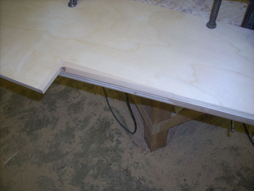

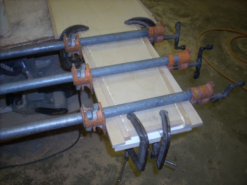

The picture above shows the panel flipped over - notice the angle part of the panel that is longer is now on top. The melamine boards make a handy place to sit the edge pieces when you are gluing them and the clamps are easier to put on.
Ready for some glue and clamps. Kind of handy to have some angle pieces around to keep the clamp faces square.

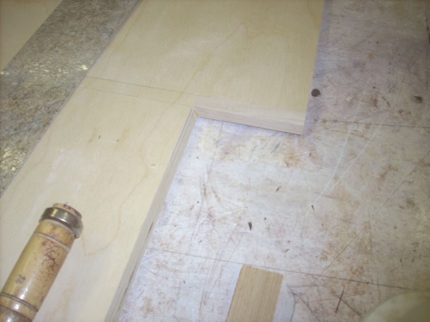

One thing to mention about fitting the edge pieces, specifically in the corner where the other edge piece had been glued on - look out for glue squeeze out.
Use that sharp chisel to get it out.

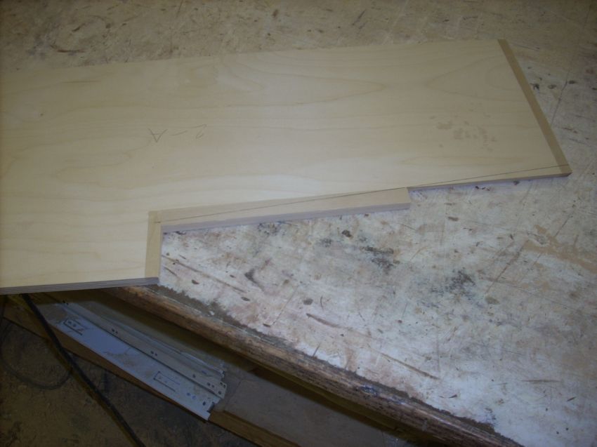

So, after the glue has dried (well at least dried enough), it is off with the clamps and under the belt sander to flush up wood edge with the plywood. Again, belt sanding on plywood is tough, better know what you are doing.
Take a look at what needs to happen with the side panels.
Oh man, I made the edge piece 1/8" longer than it needed to be
That would be all I needed after all this - glue on an edge piece that was too small.
Same process as before - trim all but an 1/8" on the bandsaw, then use the router to cut the 22.5° edge.

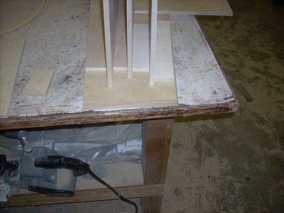

Put my side panel down and start getting the interior panels in place. This time, I get smart and lay the braces between each of the panels and what do eyes behold...
