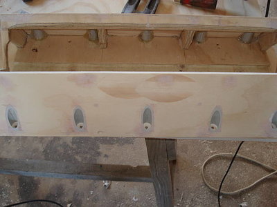

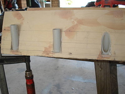

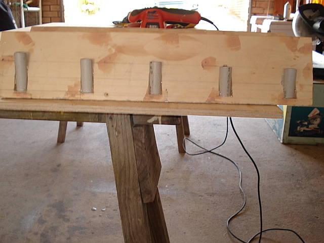

Since there is some interest in the tubes and the method, and some people are visual learners:

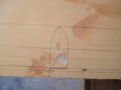

Here's the sheath drawn up to cut:
You will note the 1/2" hole for access for the jigsaw blade, and the 3/16" hole drilled from the back of the mounting plate and through sheath which becomes the centre for measuring.
The arch I described earlier is visible and is only a hand drawn guide. Trimming as necessary may be required.

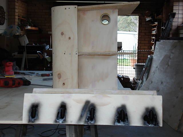

Holes are now cut, with rough cut tubes hot melt glued in place:
3 minutes later, trimming after tubes are hot glued in place and allowed to set:
3 down 2 to go...
All trimmed down after putting on bondo and sanding. What deficits?:
After bondo/bog and sanding, black makes everything disappear (the white you can see in
the pic is set hot melt glue picking up the flash):
You can note the back halves on cab 1 behind...
Critical elements in this process:
Any cut with the jigsaw needs to allow the jigsaw blade to stop fully before any movement, or large deficits in the sheath are likely to occur (learnt on the first attempt).
The openings into the sheath require small adjustments from the hand drawn arch to allow the tube to be centred on the initial hole.
When doing the lower half of the arch, remain aware of the angle of your jigsaw blade. To steep and you start cutting into the backing plate...

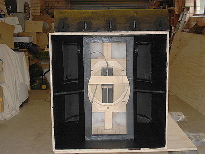

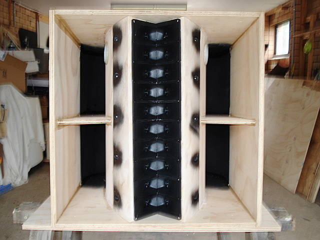

One cab completed, with melded array (diffuser yet to be added), 2 sides and back on...
Should I include my finishing time?
I spent 45 minutes on cab 2 today removing screws and filling holes with PL
Spent a few hours trimming/sanding/hole filling cab1 ready for painting...

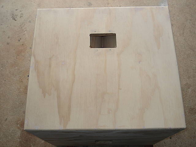

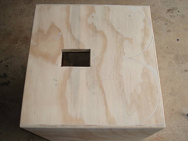

Just to prove it has a back:
Cutout is for dual NL4 plate
I like Bill's idea of putting the NL4's in the bottom for pole mounting, but I wanted to ensure the chamber is fully sealed.
This one shows the opening for the adjustable top hat and a good view of the cosmetic option result if doing the full back:

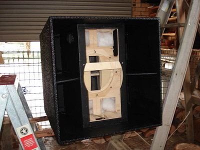

Even though it's snowing here today (which is not common, happens maybe once or twice a year) I decided to put some paint on...
Black just makes everything disappear (done with "Rockard", like Duratex)
Plain small foam roller and small brush for the inside and module. 1 coat.
Fine grade texture roller for the outside:
Then started into the filters.
I need to mull over how to make the piezo filters fit on a small piece of 1/4" ply and leave enough tails on the 4 ohm resistor in case I find the piezos too bright.
The plan is to mount the assembled (by me) filter boards on the bottom of the driver chamber, LF LP on one side and HF on the other, either side of the tophat.
I'll show a shot of the filters when done...
