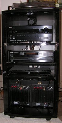

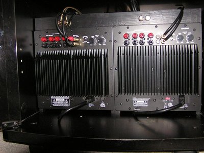

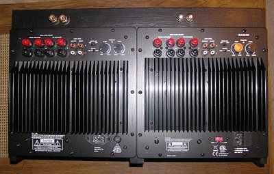

Amp Box Done
Finally got the amp box made out of scraps and took the first amp out of my original box and stuffed it in the new box. Nothing really much to look at, especially since it will be in the bottom of my equipment cabinet. But in case someone is curious as to what two SA240's look like.....here ya go!. The overall width of the ampbox is 19 5/8". I had to take the doors off to get it in.
Moving the TTLS in is next, then the experimentation begins
