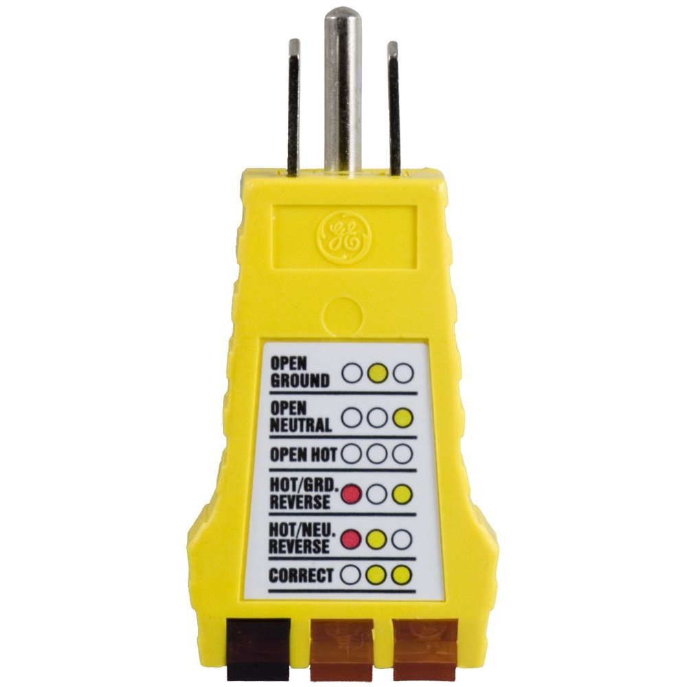

It's possible that the circuit is wired incorrectly. It will still show voltage, but could be cross-wired. Maybe the amps see that.....don't know - just a thought. Take 'em home and try.
- Posts: 8691
Re: What's to chat about?
Use one of these to check it out....
