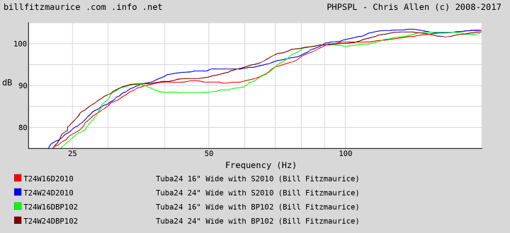

DJPhatman wrote:Missing the t24 charts. S2010 and BP102 please.
No problem:
Code: Select all
[spl]T24W16D2010,T24W24D2010,T24W16DBP102,T24W24DBP102& dbmin=75&dbmax=105&fmax=200[/spl]

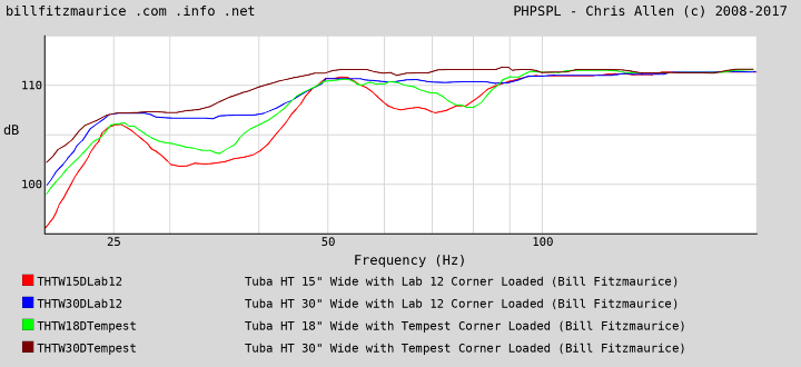

Code: Select all
[spl]THTW15DLab12,THTW30DLab12,THTW18DTempest,THTW30DTempest&dbmin=95&dbmax=115&fmax=200[/spl]
T39 comparison
Posted: Sat Jan 30, 2010 4:38 pm
by anomalous
makes an interesting comparison. with the 3012LF, going from 20" wide to 30" wide makes a massive difference.
the 3012LF is clearly the killer driver, with a 20" 3012LF going pretty close to keeping up with a 30" wide 2012 powered T39.
but what i'd like to know is: what the hell was the mystery 10" driver (blue trace) that looks to be very close to the 3012LF?! or is that a mistake...

Re: T39 comparison
Posted: Sat Jan 30, 2010 7:28 pm
by Turntablist
It's the S2010. It's very close in sensitivity in a 20" wide cab but a S2010 can only handle 1/4 the power of the 3012LF so the 3012LF will beat it by 6db.

From the chart I wasn't sure if it was a BP102 or a S2010, so I left it as just 10. Otherwise, I agree completely with turntablist post.

So, I did a quick comparison of the T36 and the THT:
And it appears that you're using THT measurements that are corner loaded. Look at the charts in this thread:
http://billfitzmaurice.info/forum/viewt ... f=12&t=953
Here's the chart in question.
The Tuba HT, freestanding, wall and corner placement, 24.5 inches wide, loaded with a Tempest Classic 15.
Is there any chance you could revise the chart to reflect 1/2 space measurements, rather than 1/8 space measurements? It would make it a lot easier to do apples-to-apples measurements....

I got the THT chart from the docs, but I can include the others as well.
