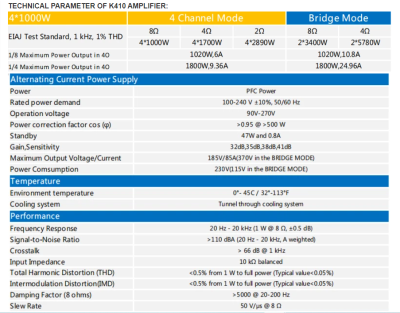

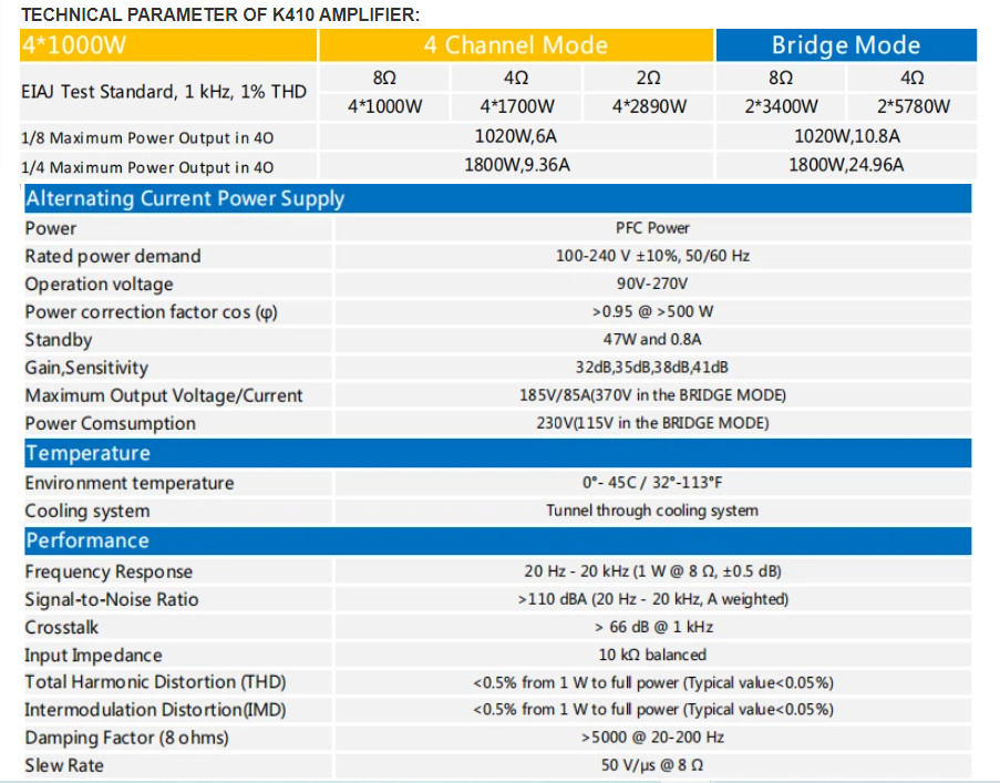

Found a deal
Admark K410 at VIP Audio
3 or more brings the price down to $850 per, shipping included!
The K410 should easily cover your needs
Admark K410 manufacturers webpage
I may be able to get some testing on the AD-430 and the Sound Town ST-UPDM4C in a couple weeks. Also, the Midas output interface came in so I'll try to test that setup at the same time.

Man, it would be really, really great if those Admark amps pass the test! More than great, actually. Absolutely fantastic!!!
