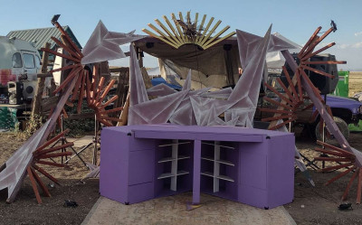

I have finally gotten started finishing my first pair.
They are sanded, caulked, routered, primed and the first coat of duratex is on them.
I have two events coming up next month, on consecutive weekends, that I have to run my system at.
I have also checked and replaced the gaskets on my access ports, as well as built a matching triangle, and brance to set them up in a v-plate configuration. The brace is for the middle of the v-plate, and so that I don't have to worry about people sitting/dancing on the subs.
I am still planning on making more, it's just been a slow process. But I have all of the materials to make the next pair.
Then my plan is to work on tops and monitors, to replace all my self-powered JBLs. But that part is probably a way out

I have more pictures of the painting/finishing, but they are on another memory card, that I have misplaced somewhere.
They were primed and given a single coat of duratex. Both tinted purple. With the braces in the mouth painted white.
V-plate and brace painted to match.
I added the vertical brace to the v-plate sopeople could dance and sit on it, and I am on replacing it with fancy bracing that looks nicer and matches the subs.

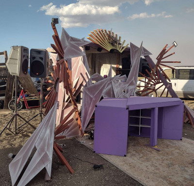

Anyway, they preformed great. The V-plate made an immediate, noticable difference. The bass was plenty loud, and clean enough to have a normal conversation right in front of them. Even our old buddy who doesn't really like bass and electronic music was impressed with how you can feel the bass without it blasting your ears.
Setup from second event, DJ booth in the middle.

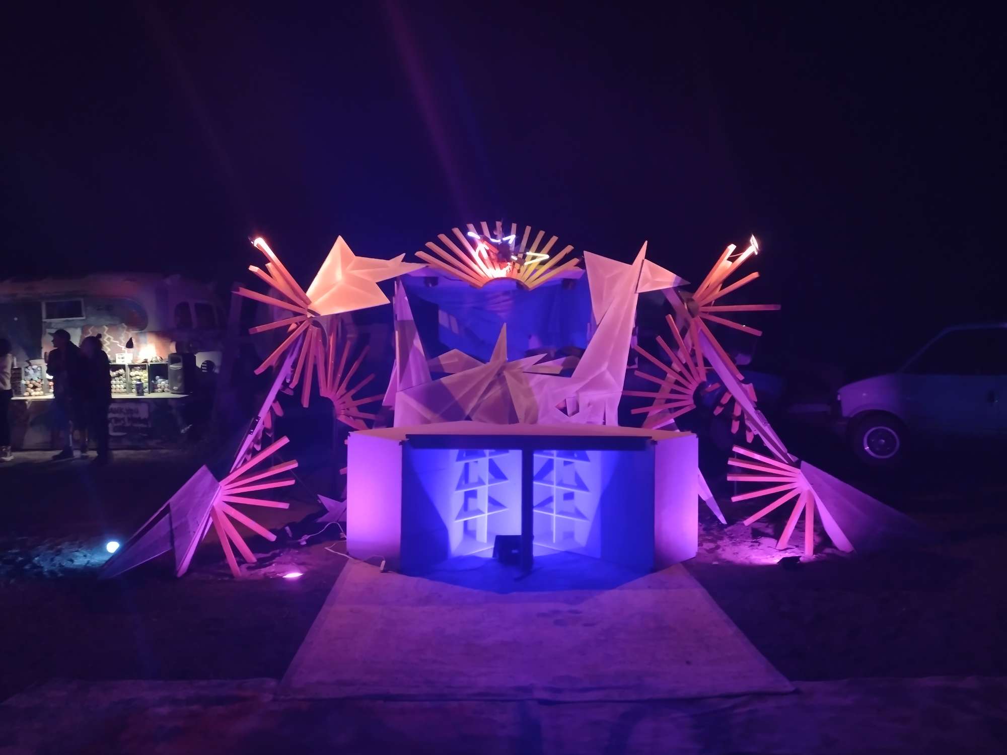

At night with lighting

Love the purple look! Especially lit up. Can't wait to get my build done. It's getting close.
