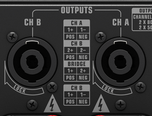

Also, on the back of your sub amp, there's an input sensitivity switch. Ensure it's set to 1.4v and the limiter switch is set to off.
Additionally, the "Mode" should be set to mono and ground lift set to GND.

Do you know if the cables you used are 4 conductor cables or do you have a link to the cables you used?LioninSpace wrote: ↑Mon Sep 19, 2022 2:41 am I have used a pre-made cable to insure its not the cables
I may have found a slight problem.
The channel A Speakon connector on the amplifier is wired with both, channels A and B. So, you could send both channels on one 4 conductor cable, daisy chained to two different speakers that are appropriately wired. Handy. Good design. But, the 4 pole Speakon jack connections to the switchable passive crossover PCB in the subwoofers appear to parallel the two channels together, connecting channel A+ to channel B+, and A- to B-. Super unintelligent design. It should absolutely not be that way. It's rather amazing that I even spotted and recognized the issue. Such a random thing.
I'm not sure if that has any bearing on your issues, but it could. I honestly have no idea how an amplifier would respond to having it's outputs wired together in parallel. If you're only using 2 conductor speaker cables, it's not your problem and not something we have to worry about. If you are using 4 conductor cables, we'll have to discuss possible solutions.

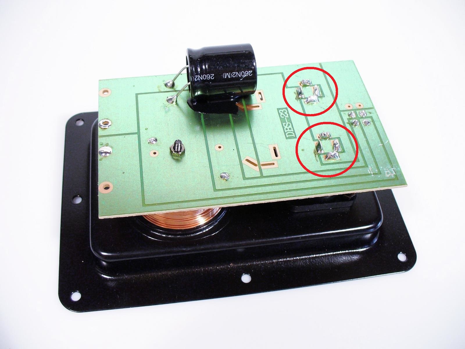

Link to the page the speaker PCB pic came from.
