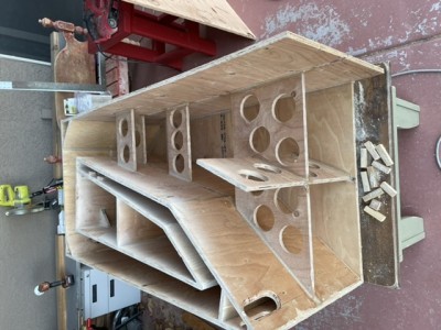

Making progress, slowly but surely. At this point I will be really sad if these MCM drivers prove too low quality or the 8” dia size compromises the design. I have been pouring blood and money into this. I wish I had a better shop and some pro grade tooling to use. Between the $55.00 per sheet bowed and flawed plywood and all my hand tool limitations, these builds are hard.

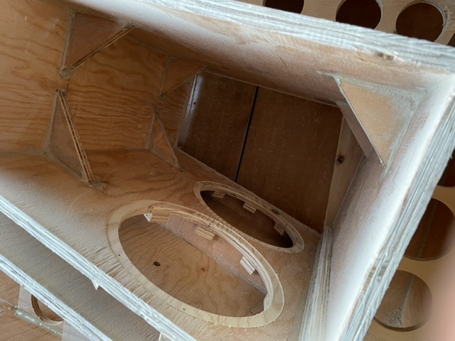

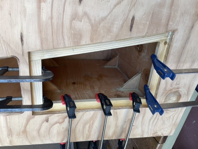

Wild hair, I put some bracing into the sealed portion of the driver chamber for fun, not sure I needed to just found my self wanting to!!!

Just for any future endeavours: bracing in general is meant to prevent the panels from flexing when pressure increases/decreases on one side of the panel relative to the other side. The flexing tends to max out right in the middle of your panels. Your braces are mostly in the corners, where there is less flexing going on. This style of bracing is not useless: it strengthens the connection between the panels. However it would have been even more effective right in the middle of each panel.
Nitpicking session is over. Normal service will now resume
There is no such thing as too much bracing. From that point of view, I'd say well done. I don't think your cab will fall apart anytime soon and that is an understatement.

Those braces won't have any effect, as they're so close to the corner joints, the strongest place in the cab. A compression strut brace would be useful if it was at least 6 inches out from the corner, and if there was no bracing on the opposite side of the panels being braced.

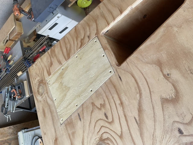

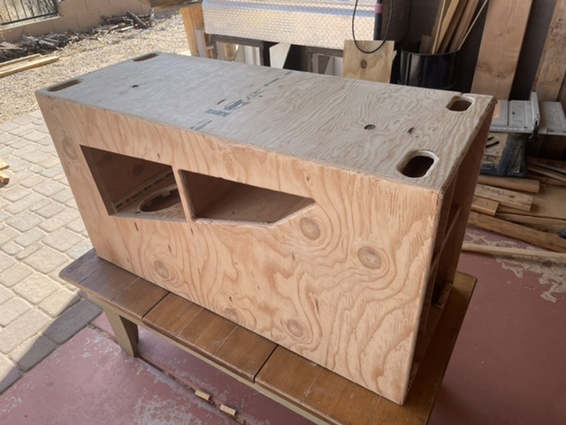

Final side installed, all handles cut in. I wanted the handles as wide as possible, I did not account for the plastic cabinet corners. I may have placed the handles so wide that the corner protectors overlap. Darn, was not thinking about it. At this point I am saving my money for the drivers and some duratex!

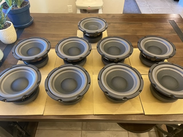

I saved my monies up and purchased some MCM 8” drivers. I am putting a lot of faith in these super cheap little drivers. I bought 8 of them. At $30 ea I only spent what one Lab12 driver costs, crazy! I also ordered the parts to complete the cab, corners, connectors, gasket tape and a gallon of duratex, roller grade.

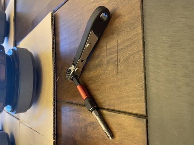

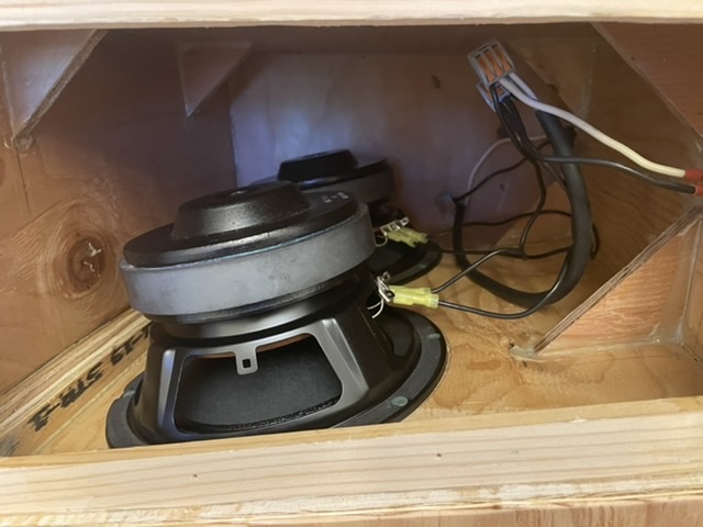

I wanted to show you the tool I use to install my drivers into the enclosures, little ratchet thingy. I’m going to build the horn up with no finishing effort and demo it out and see how it goes. More to follow.

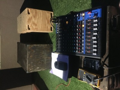

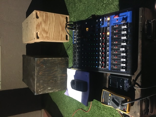

So today I did some initial testing of my 18.5” tuba45 dual MCM55-2421 8” subwoofer. I set up one of my 24”wide tuba45 loaded with lab12. Both cabs were placed facing my back wall outside about 12” off the wall as seen in the picture. I was about 8 ft back from the cabs with my meter. The meter I used to do these initial tests is an old RadioShack spl meter. I started with the 24” wide cab, set the voltage output to 2.83v and ran some tones through the rig. I ran sweeps today between 35-48hz only. At one watt about one meter wall loaded but outside the 24” cab put 91dbspl on my meter with a peak at 48hz of 96dbspl.
Now help me out on this one, if the driver is 6ohm and the cab adds 2ohm for a 8ohm nominal, (2.83v/8)x(2.83)=1watt. So with my dual MCM8”s in series I have 8ohm plus 2 from cab for nominal of10ohms, right? Then (3.165/10)x(3.165)=1watt. so in order to try and match power to spl I ran my 18.5in wide cab at 3.165v.
At 35hz on 3.165v same setup as before yielded 91dbspl at the meter. Then peaked on 48hz at 97dbspl same 3.165v. This excited me sweeping across this 35-48hz range had similar response between the two cabs just going off my hand held spl meter.
For today I ended my little session on some peaks. My limiter is set to stop at 47-48v, I tapped out my 24” lab12 cab on 35hz at a peak 114dbspl at 47.5v and then hit it again at 60hz same 47.5v for a peak 122dbspl on my meter. Then I did the same thing with my 18.5” MCM sub, on 35hz at 47.5v I measured 112dbspl and at 60hz same 47.5v 118dbspl. I realize that my meter is not the most accurate unit but I am pretty confident with it plus or minus a db.
