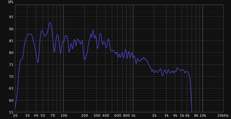

I got my REW program out for some other things but figured I would run a sweep on my system. 1/12 smoothing. I was playing with my laptop and ran this loop through my apple play into my tv then through my receiver. I ran an rca straight through the receiver and the only difference was that apple play/Bluetooth cut past 6-8khz.
I have a nasty hole at 42hz :cussing: son of a bass trap!!!

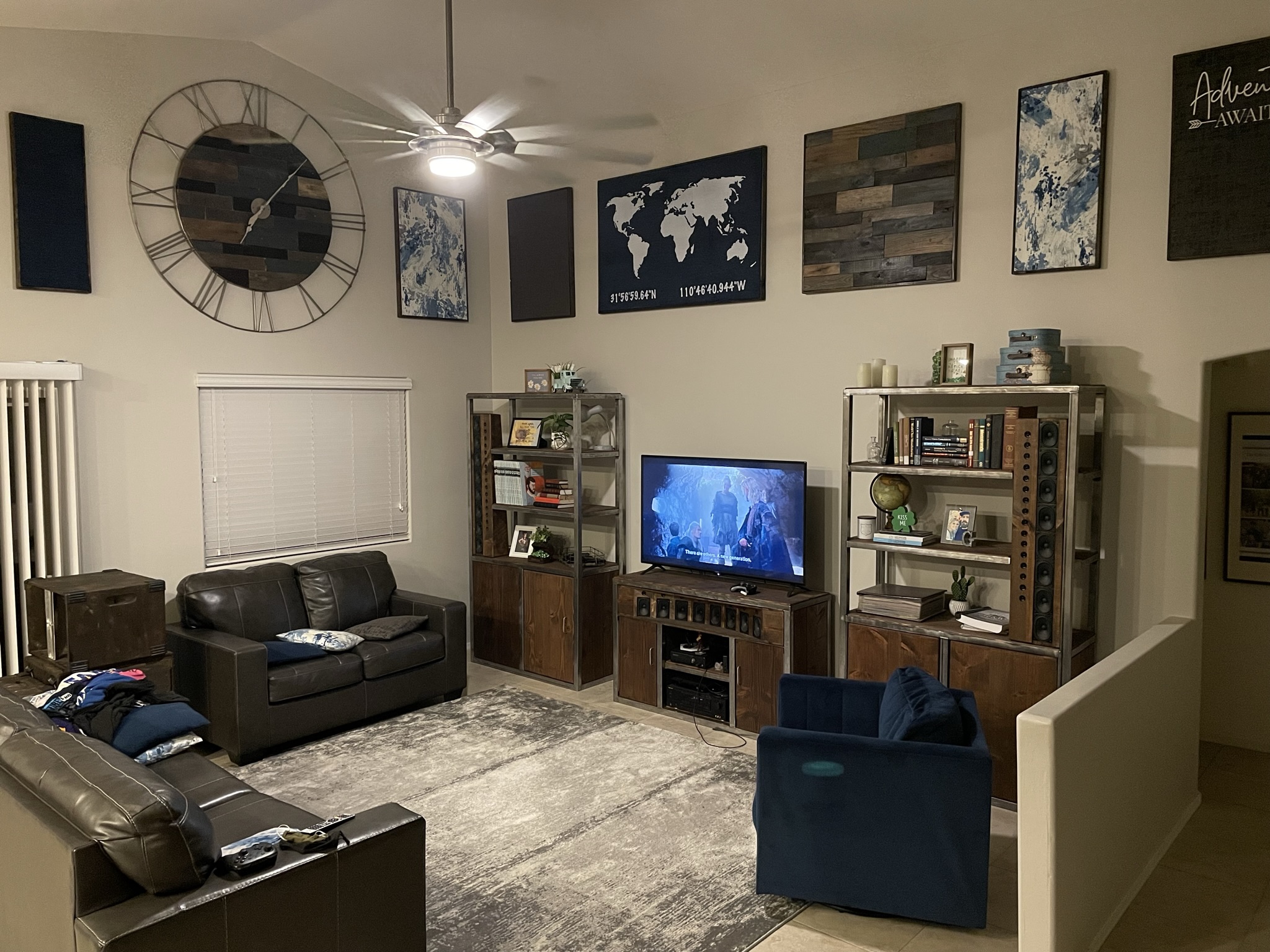

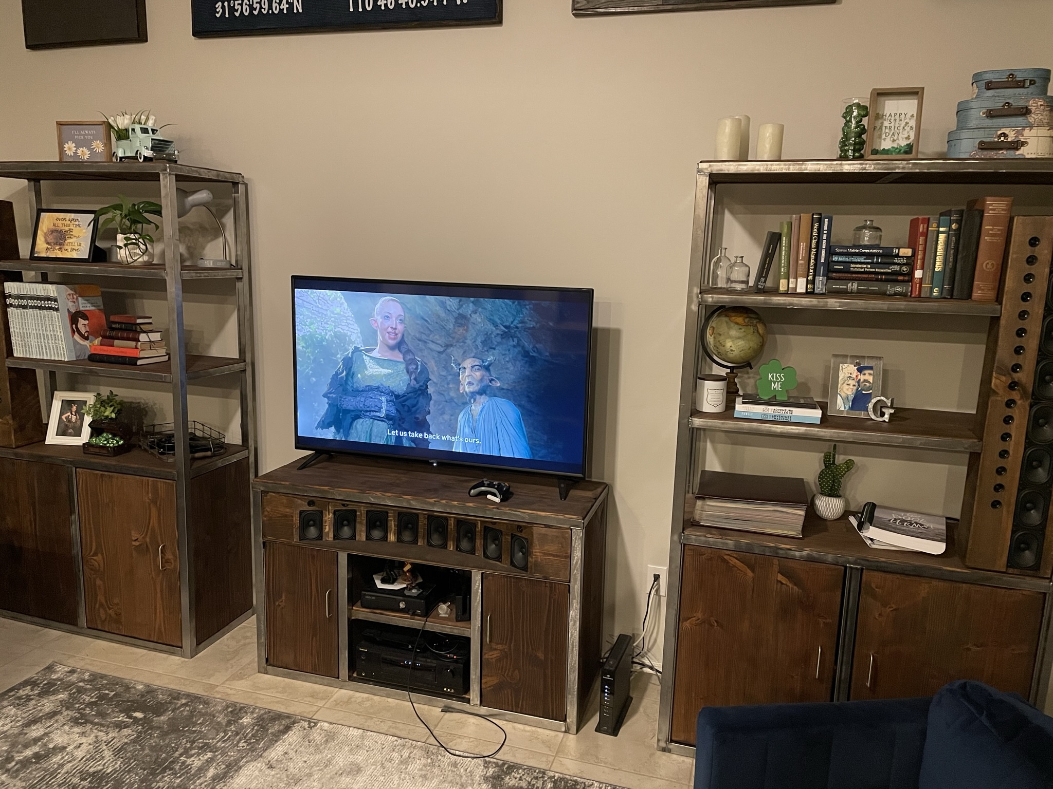

Pics to show my wife’s efforts to clutter/decor the shelves just like we planned for her to!

Where did you take the measurement from?
Did you try it at each seat to find the best one? :hyper:

Is the LP tight to the back wall? A dip at 42Hz would be caused if it's about 6.5 feet out.

I only took the one measurement and I took it from where I typically sit, front and center. What do you mean by LP? I am drawing a blank.

8ft from the wall on the left, 12ft from the tv wall. Listening position, man I racked my brain on that one, silly me.

How far from the wall behind you?

Rear wall is about 16-18ft, ceiling is about 12ft high, the wall on the right is complicated

Take a measurement with the mic less than 2 feet from the rear wall. If the dip goes away you found the cause. Also, set the resolution to 1/6 octave. You can't hear better than that, so there's no point chasing response better than that.
