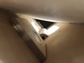

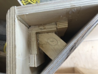

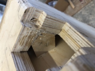

Did the caster cutouts, with some messy (don't judge!!) but solid reinforcement. I took the cutouts and split them in two, then glued them to the underside to provide a second thickness of ply to screw the casters through. Then trimmed some 5/16 pieces to fit between there and the backside of the corner panels. Had to trim out a little pocket for where the bolts on either side of the axels can fit. Overdone, for sure, but super strong.
I put 3/4 x 3/4 quarter round under the rear handle cutouts. I notched out the back so I could route the 14g wire from one speakon to the other. That way I'll just have a single penetration into the driver chamber from the rear jacks, and another from the front pair. Last time I routed each of the 4 speakons separately.

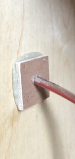

At the speaker wire penetrations, I remember fussing with PL to get a good seal last time around. This time I took some little squares of thin ply and cut two side by side holes to fit the wire fairly snug. Then I blooped some PL, slid the square down tight and pinned them to cure. Should swell up and guarantee a nice airtight seal.
Cut out some little circles of 1/2 ply to fit under the front rubber feet, so they will match the height of the casters in the back.
That's it for now. Hurting and can't mess with anything large or heavy for a while. Will post some pictures shortly to help show the progress.

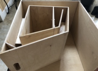

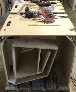

A few pics
