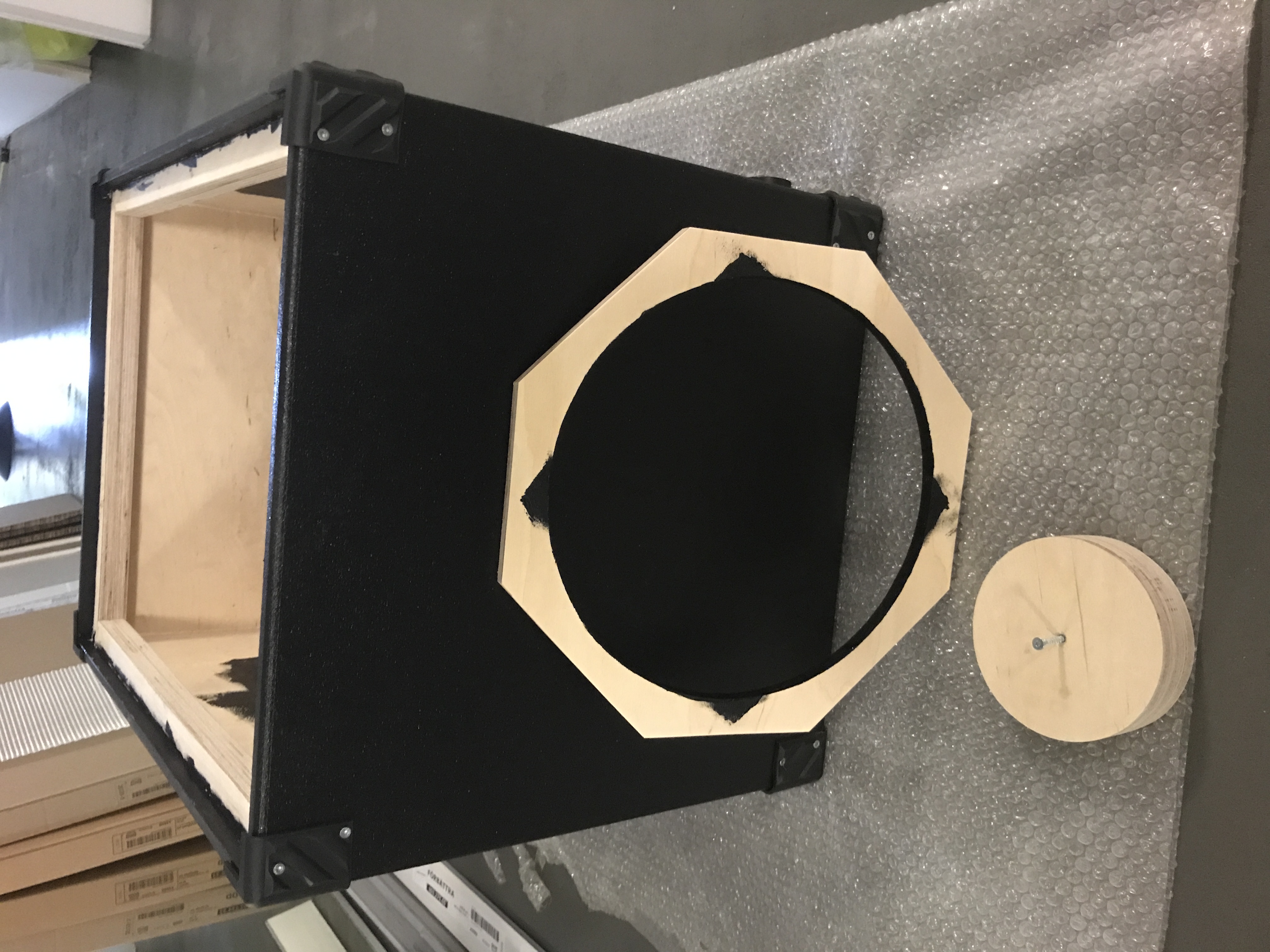

#70 Post by Rickyvt »
Started painting one of the Jacks, found some time to make the phase plug and spacer yesterday. Mental note: never promise your wife to do something whenever you will have enough time to do it, she will remember...
