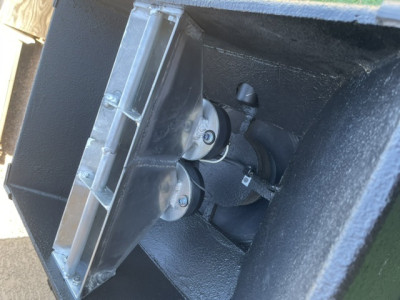

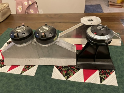

Bill is going to have a cow, but I did this to try out the idea. I am not worried about the highs out running the mids so much as maintaining as much fidelity as I can. Seeing as I have blown some of my high freq drivers I believe I should fortify that some.

I have done some basic testing with this dual driver setup. I am still running the Asd-1001 drivers at the moment. I have them wired in series. Output is about the same, double the displacement and the impedance makes sense to me.
I have been trying different crossover points despite what those drivers should be limited to.
How do they do preform? About the same eq needed as before. I can’t tell that there is any real dramatic negative effects with the dual configured horn. It all sounds the same to me from all angles.

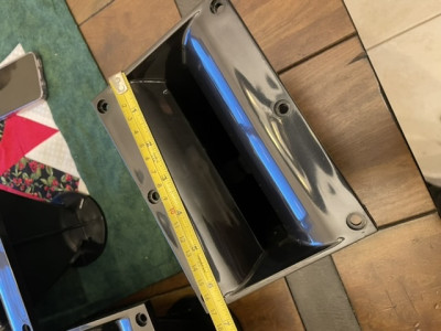

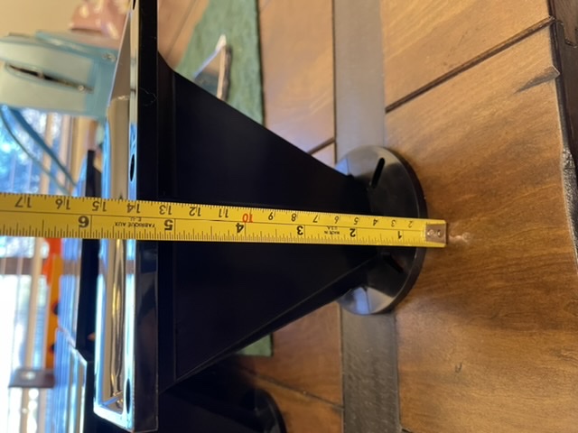

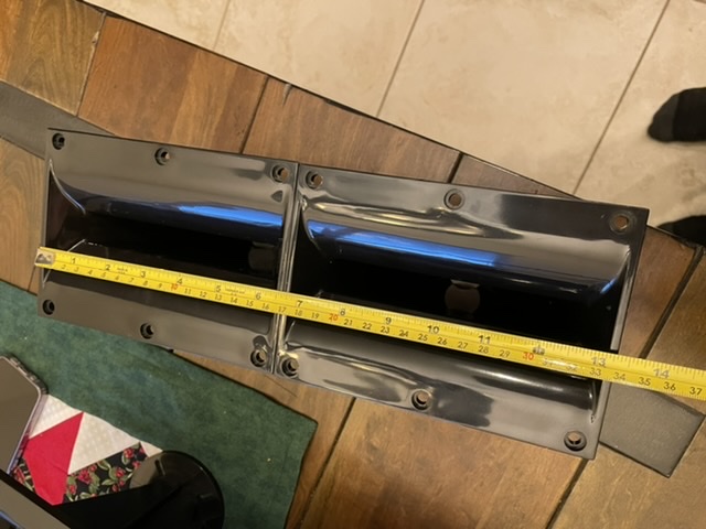

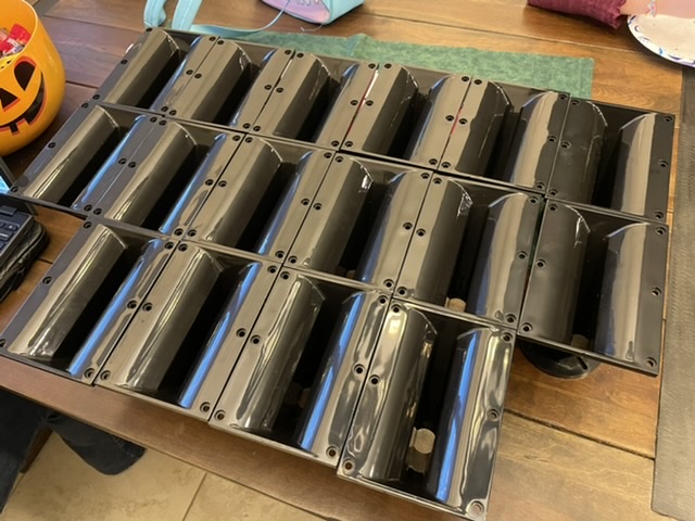

I did a thing! I found a part on aliexpress that is pretty close to the right form factor for the high frequency horn of my otop12 speakers.
https://m.aliexpress.us/item/325680191 ... _shipto=US

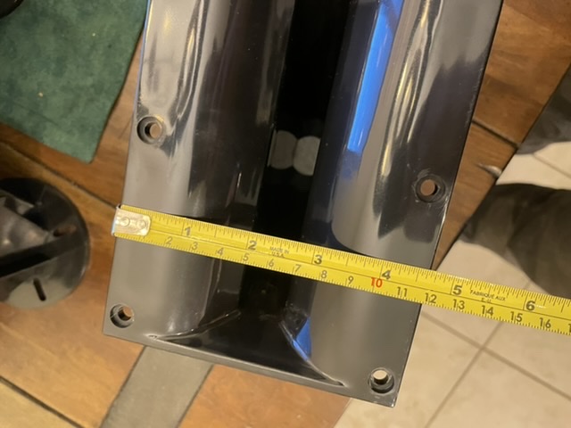

They are not perfect but they are close enough that I went ahead and bought a grip of them. The length per unit is 6 5/8” tall for 13 1/4” with two. They are an inch wider than the prescribed horn but they are only about a 1/4” taller. I paid $16 each for 16 units and that includes shipping.
I intend to set them up and do some testing soon after I sort out a way to mount them! I shall report my findings

yeah, I have Room Wizard EQ. I would like to graph a hand full of situations.
-Single alum horn - ASD-1001 2k high pass
-Dual alum horn - ASD-1001 2k high pass
-Dual alum horn - ASD-1001 1.2k high pass
-Dual wood horn - ASD-1001 1.2k high pass
-Single alum horn - F151M-8 1.2k high pass
-Dual alum horn - F151M-8 1.2k high pass
-Dual wood horn - F151M-8 1.2 k high pass
-New plastic dual horn - Asd-1001 2k high pass
-New plastic dual horn - Asd-1001 1.2k high pass
-New plastic dual horn - F151M-8 1.2k high pass
It will take me a few days to coordinate this effort, but I am really curious to see what I get with these different configurations. I will put up a post about it.
