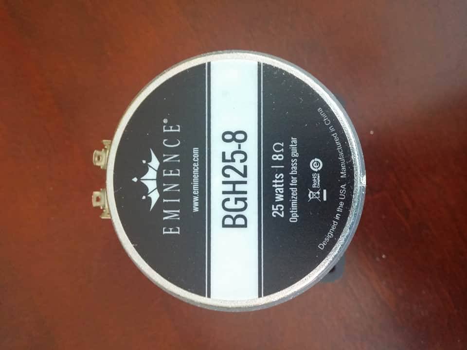

Is it normal it's not written anything about "kappalite 3012lf" on the woofers?

Electric Wisdom wrote: Fri Mar 09, 2018 7:31 pm 28908444_10151101503389984_1766498231_n.jpg
I've never understood why they don't label those. There should be a part number label that you can cross-reference on the speaker somewhere.......

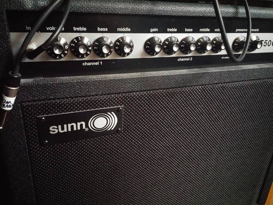

Got some nice black cover for my Sunn amp before diving more into the cab building, the grill was so old and dirty, now super fancy :)

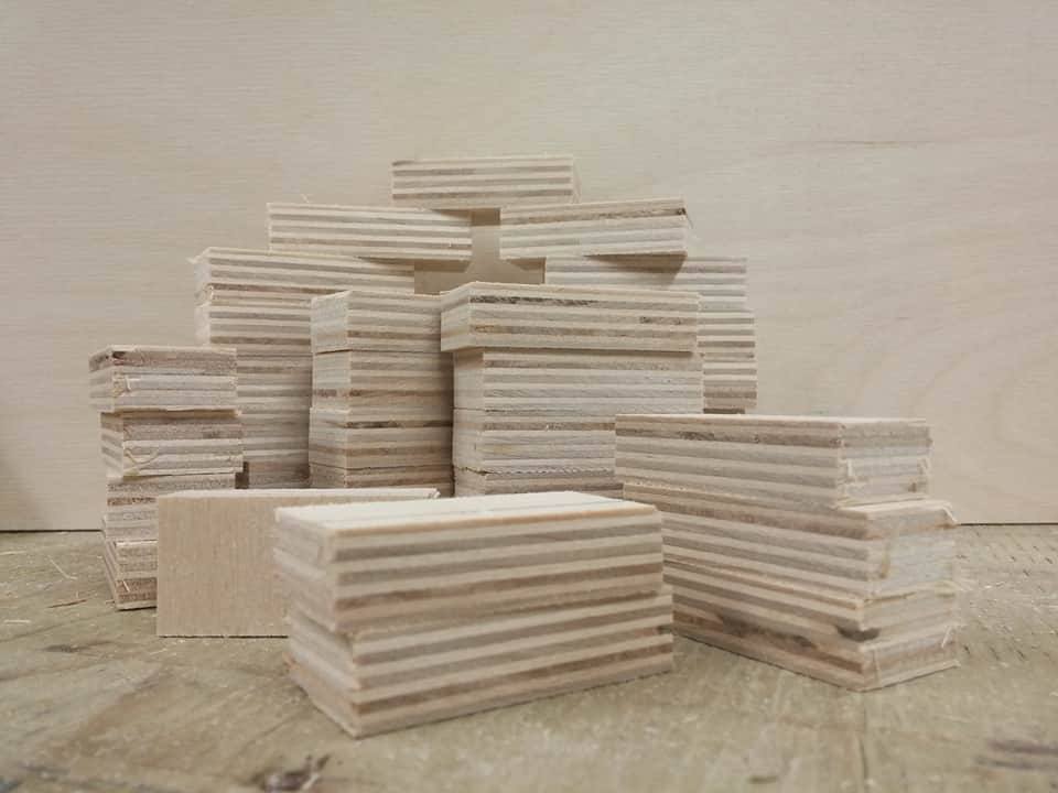

#65 Post by Electric Wisdom »
All the little back pieces for speakers in the baffles.

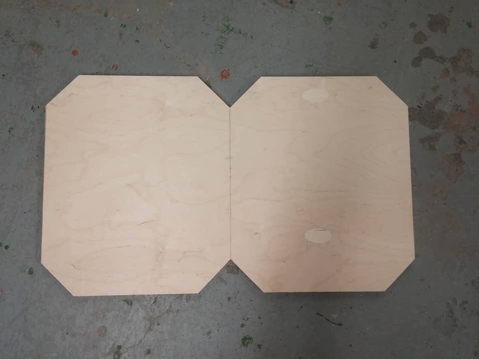

#66 Post by Electric Wisdom »
Damnit lol, really must measure 3 times, cut once, that shit is real hahahaha :wall: :wall:

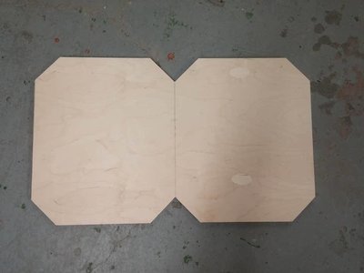

#67 Post by Electric Wisdom »
Baffle picture.
Looks like i cutted all the 16 ports vents with the angles 1/8" too small... i'll do them again.. xd

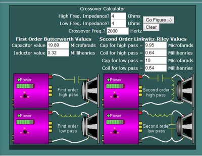

#73 Post by Electric Wisdom »
Bill Fitzmaurice wrote: Mon Mar 12, 2018 2:40 pm Read this:
http://www.bcae1.com/xoorder.htm
You can use polys as shunts. They won't work any better, and they cost more, so why would you? I don't.
Ok so i tried that calculator and it seems i use it wrong because it doesnt generate the same values as the build document?
Posts: 29087
#74 Post by Bill Fitzmaurice »
The document was recommended to show you how crossovers work. The crossovers we used are optimized, not generic, so they won't have the same component values.

#75 Post by Electric Wisdom »
Bill Fitzmaurice wrote: Wed Mar 14, 2018 7:09 am The document was recommended to show you how crossovers work. The crossovers we used are optimized, not generic, so they won't have the same component values.
Ah ok that calculator is like a recommendation startpoint then, i get it thanks :)
But the caps for tweeters are not close to the values on that calculator isnt it?
The other ones seems close tho
