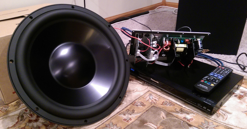

Thanks! My PE order will be here tomorrow, a full day ahead of schedule. Plan on breaking in the driver starting tomorrow, so that's out of the way. Hope to start the build this weekend.

I'm breaking in the driver. So, that's one step I won't have to worry about. :hyper:
