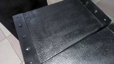

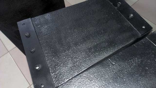

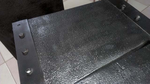

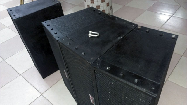

I can't endorse it of course, but it's being done the right way, with the steel carrying the weight of the array, not the cabinets.cave wrote:Today we continued with installing the hardware and applying acrylic paint as primer so here are some pictures for you.

I have built some arrays with this hardware and they are solid but a bit crudeBill Fitzmaurice wrote:I can't endorse it of course, but it's being done the right way, with the steel carrying the weight of the array, not the cabinets.

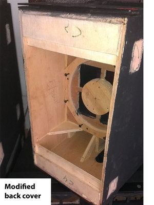

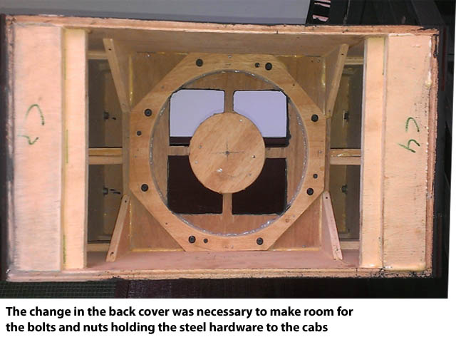

We had to modify the back cover. The most important thing here we considered is making it air tight.

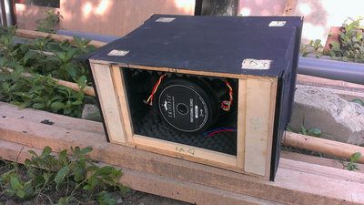

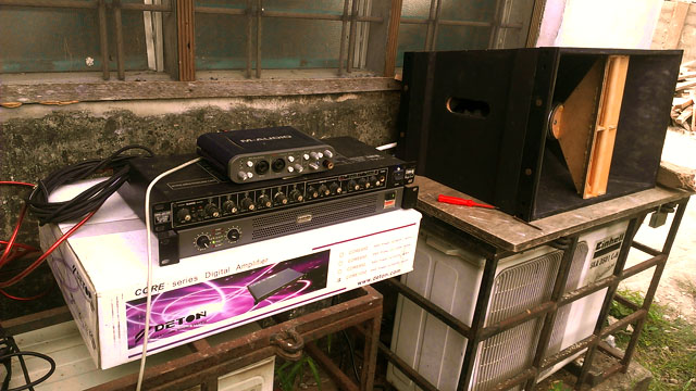

Folks we are gradually getting to the finish line. Today we installed the drivers and lined the cabs with foam. Before then, we finished fitting one cab and player music through to inspire us as we worked. Without any equalization, the music already sounded clean and crispy. Every detail came through clearly. I just cant wait to llisten to the full array. we will finish with all the connections ane back covers ill post some pix soon.

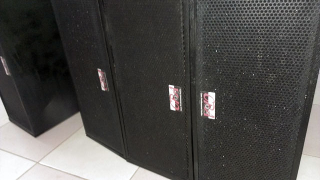

Hi lovely people, after almost four months of absence I am back to tell you we have a really good looking set of cabs ready for a major out door program.

cave wrote:Hi lovely people, after almost four months of absence I am back to tell you we have a really good looking set of cabs ready for a major out door program.
Re: OTOP 12 JARRAY PROJECT.
You do realize we expect a full review and video, RIGHT? Great job on the builds
