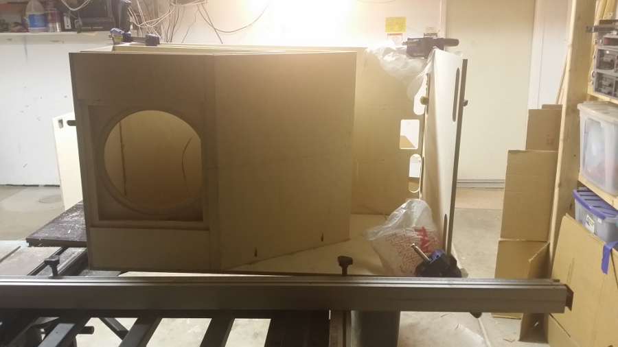

Thanks for the advice - I decided to bring cabinet 2 up to "everything but the final side", and then paint the insides of both. The braces are sturdy, I picked up the cabinet by a couple braces tonight. That PL is strong! I've made good progress on cabinet two this week - I installed the 4 driver flanges, the 4 little braces, 2 panel 7s, as well as panels 8,9, and 10.
Now I just need to add panel 11 and the 6/10 braces and cab 2 will be caught up to cab 1.

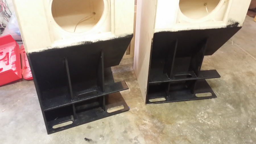

I finally got some time today to do some work, and painted the horn mouths, in anticipation of putting the second sides on. Some quality time with my Duratex roller.

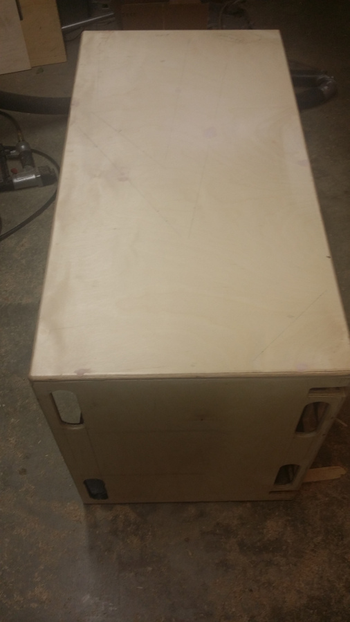

Tonight I sanded, bondoed, and sanded the first T39. I used a belt sander to even things out around the edges, took out the screws from the final side, and filled the holes with bondo. Using the brad gun on all but the final side made this step go pretty well - only 9 holes, and I got them all with one batch of bondo before it hardened.
Then I rounded over all of the edges. Here's that final side:

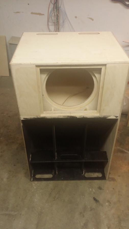

Here's a front view of the cab, ready for paint:
Another question: The plans say to install the access cover with either screws or bolts with blind nuts. The screws sound easier, but the blind nuts give me more confidence I can re-seal the panel if I ever have to take it off. What have others done?

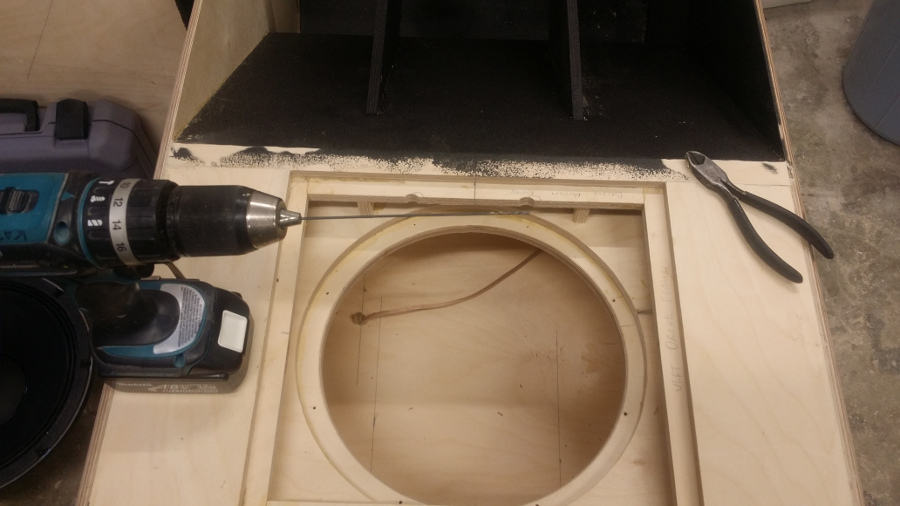

Well, it has ben many months (did we really discuss the access cover last June?) since I worked on my T39s, as I've been busy with the DR250s. But today some glue had to dry on the DR, so I came back to the Titan. At this point finishing one Titan and one DR will be great for my son's graduation party later this spring. I now have a driverack and just bought a used mixer. Speaker stands for the DRs and an amp will let me fire the system up!Bill Fitzmaurice wrote:+1, though I put a nail through the first two holes drilled to keep the panel from wandering when drilling the rest of the holes.Bruce Weldy wrote:I just position the cover where I want it, then drill a pilot hole all the way through both panels. Then it's lined up. No marking necessary.
The first thing I realized (while I was mounting the woofer on the DR) was that I really should have drilled pilot holes for the woofer before putting the front flanges on the cabinet. However a trip to the hardware store came up with this beauty: a 6" long 1/16" diameter drill bit! With that (and only a tiny bit of relief with the Dremel) I was able to drill pilot holes, and run the Recex screws in and out of the woofer mounting holes. I think I'm ready for the woofer. Then I turned my attention to the access cover. I decided on 10-32 oval hex-head screws and hurricane nuts. as Bruce and Bill suggested I drilled one hole, put a nail in, drilled a hole in the opposite corner, added a second nail, and then drilled pilot holes. I chose 14 screws with the sides just under 4" apart and the top/bottom 3 1/4" apart. I then drilled all of the holes bigger to clear the 10-32 screws, and then enlarged the holes in the flange to the 1/4" required for the hurricane nuts. I pulled in the hurricane nuts with the cover off, and everything lined up perfectly. I also cut out the cover braces today.

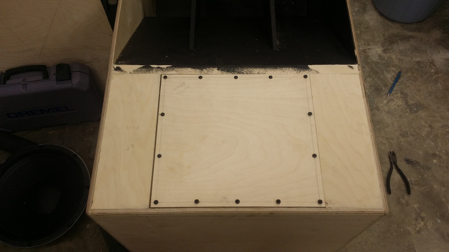

here's the cover on with all the screws in (no gasket tape yet). Next up is a coat of Duratex.
Any suggestions on how to get the front painted in such a way that:
a) the hurricane threads don't get jammed with paint
b) the screws don't get their sockets jammed with paint
c) everything gets painted
After the Duratex I just need to mount the driver, jack plate, wheels and corners.
